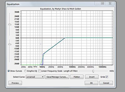

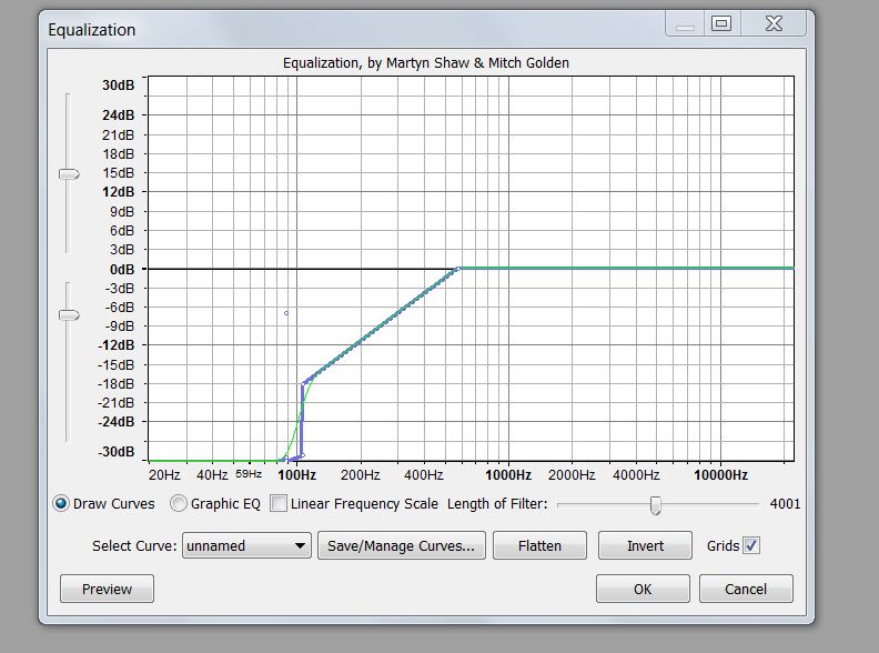

Thinking you could EQ a lot of that bass to a better balance, I played with it superficially in Soundbooth and got some more pleasing result.
I'm a volunteer machinist at the Gold Coast Railroad Museum here in Miami, where we run an EMD GP7 road switcher and an Alco Rs1---the predominant sound you hear on them is the 16 cylinder Diesels and, on the Alco, a 3300-pound air compressor that's driven directly by the engine, making a very loud rhythmic pulse. There's very little to them in mid-range or high frequencies, unless braking or venting air or ringing the warning bell or something.
Inside the cab, you feel the bass in your chest, it smothers everything. So what you are getting is pretty much the sound of the locomotive itself, which pretty much covers up any other sound. Perhaps you need to pick up more ambient sound---reflected sound from the area around train itself, rather than direct sound of the engine, and blend them? Maybe point a cardioid off-axis, just a thought as I haven't tried this myself......
I'm attaching a file I made with a low-cut eq in Audacity, and a screen grab of the eq curve, for what it's worth. I'm sure it can be improved, but maybe this is a step in the right direction....
