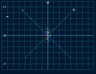

I've been listening and looking at the audio in the closer miked version, and there's quite a bit of pumping as the AGC struggles to handle the music. It's also a rather harsh setting, it has fast attack and a fast release, so you often hear things you shouldn't - I'm not sure if it is a sniff, or clothes, or something else, but you hear it when a loud transient is followed by one of those up-bow flourishes. I think, however, the placement nearly works. It sounds nice. The viola is a bit lost, and 1st violin (your GF?) a bit OTT - but the cello sounds nice. The Rode mic has done a better job than frankly, I would have guessed. What got me confused a little is that although the stereo image seemed present, was that it seemed very narrow. I stuck it into my studio system and looked at it. The room is very live and the mic has captured that very well, but there's a 'hole in the middle'. The Rode spec info on their site is a bit rubbish - it simply says the mic is cardioid and shows a nice single cardioid polar diagram, so I can only assume this is the spec for one capsule, and in the X/Y format, they've probably gone for 90 degrees offset, so the 2nd violin and viola are in the null in the middle. This problem is pretty typical, to be honest, and lots of faffing around with mic placement is the key. Don't forget the stands are also pretty effective acoustic barriers. You could also perhaps experiment with their seating - perhaps just pulling out cello and 1st violin - a gentle curve rather than the fairly tight arc. The room probably sounds gorgeous, but it's very lively.
