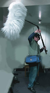

The last two times I had someone to run sound in the field, they carried my field mixer in a portabrace case hanging on a Lowepro harness. We did not use a boompole. It seemed to be kind of low on them. I've since seen some operators in BTS photos recently that use a shoulder strap and have the mixer to the side ... on their hip... especially when using a boompole. I'm adding a boompole this time.
When you are running sound with a boompole, how do you like to carry your mixer bag? Front or side or what?
