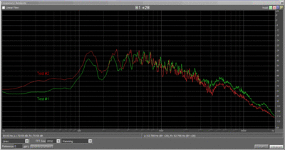

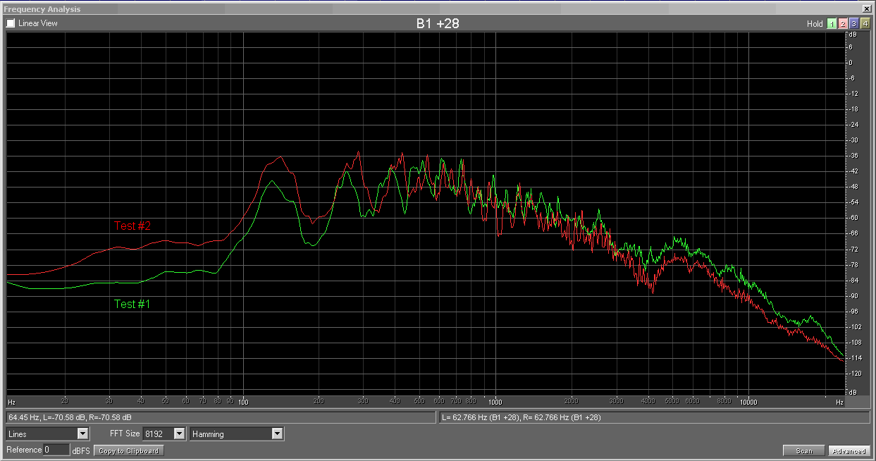

Sorry, but I certainly can't agree with you there. Test #1 (counting backwards) is much brighter, with more highs. Test #2 is more mellow, although not what I'd call "muddy," but it definitely has less HF content.
Attached is a frequency scan of the two files to illustrate what I hear. The green trace is Test #1, the red trace is Test #2.
Note that Test #1 has less LF content, up to about 800 Hz, where the two traces more or less cross. Once you get above 1,000 Hz, Test #1 clearly has much more HF content than Test #2. Test #2 is definitely muffled.
That's very interesting! To my ears #1 sounds muffled, whereas #2 sounds "broader". But your graph clearly proves otherwise. Let me run the test with the XLR cable and I will post it here.
