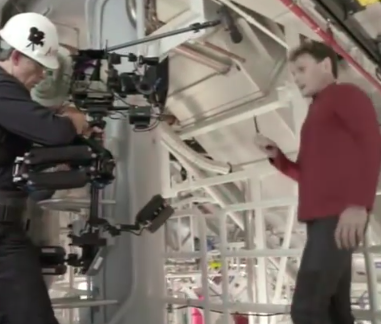

I'm a fanboy, especially Star Trek. So, I've attached an image from one of the BTS shots. I'm wondering what mic that is, or perhaps something similar. Thank you for your kinds words of wisdom.

Can't see it well enough to say what the mic in your pic might be. Any one of several small-diaphram hyper-cardioid mics like the Schoeps CMC641 is a safe guess.

Agreed - and the mic. in the OP picture could well be an MKH 50.
