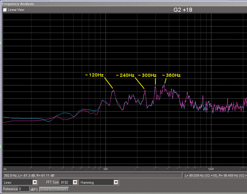

At first listen, the brief SM58 voice sample sounds better than the camera mic in some ways. It might be helpful to understand why.
First of all, the SM58 level (as measured with CoolEdit's RMS analysis) is about -12dB lower than the camera mic. That lower level makes the background noise much less audible. But if you boost the SM58 recording by 12dB, so it's roughly the same level as the camera mic, then the room noise becomes more audible. Not exactly the same tonal quality as the camera mic, but we'll come back to that.
Certainly the voice with the SM58 sounds more pleasant ... warmer. Indeed, the SM58 is designed to sound good up close with voice. It's a good mic to have on a stand for the solo performer in question. That doesn't necessarily mean it's the most accurate mic when recording sound of a large ensemble, or sound at a distance... but it does sound nice and warm when used close. And just because the SM58 is designed for solo work does not mean there's anything wrong with the camera mic.
As to the room noise, CoolEdit's frequency analysis graph [see attached image] shows that it's predominantly around 120Hz, 240Hz, 300Hz, and 360Hz, all of which are harmonics of the AC power line frequency. I would guess that the noise comes from either a motor (cooling fan, refrigerator, HVAC motor, etc.) or perhaps fluorescent light ballasts. There's no question that the camera mic picks it up, but that's just because it's doing a good job of accurately picking up the sound in the room. It's also present in the recording with the SM58, but it's less audible because the overall level of the SM58 recording is so much lower.
I've attached an audio clip, made by downloading your EweToob file, then keeping just the audio. After that, I raised the level of the SM58 portion by 12dB so that you can compare "apples to apples" at the same relative level. You'll note that the room noise is now more obvious. It does, indeed, sound different in quality, compared to the camera mic... that's to be expected, because they are very different mics.
