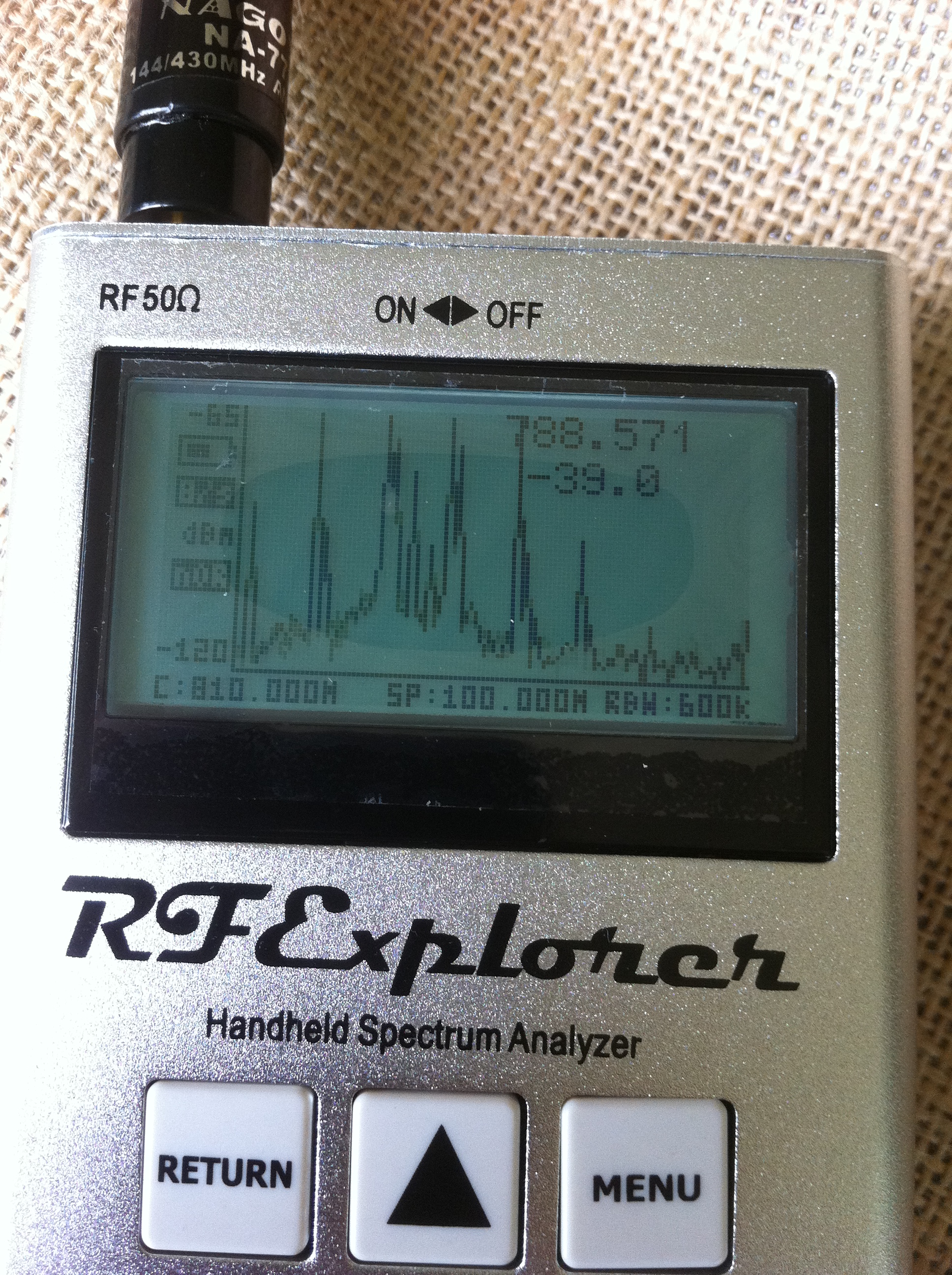

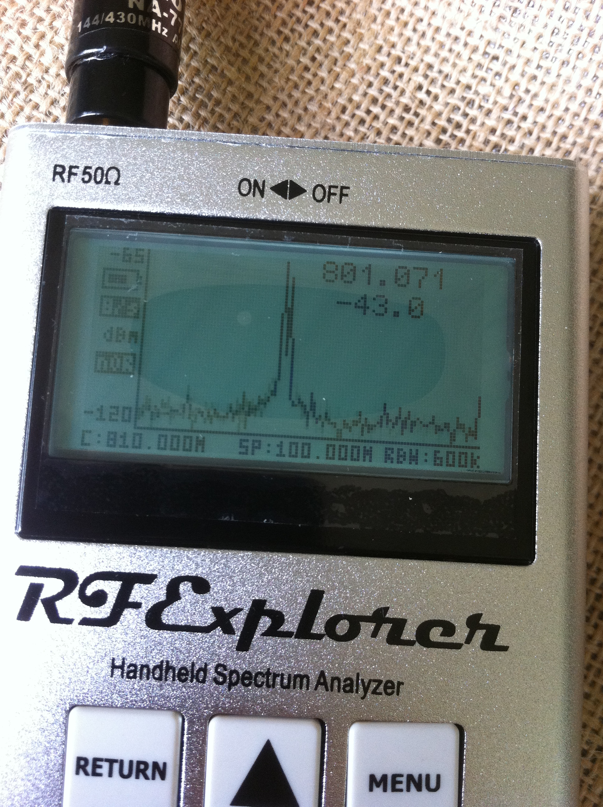

Here are some screen shots of my RF Explorer.....
I would use it a couple of times a week for location shoots..
Simple, cheap and effective.
Buy RF Explorer model WSUB1G [TES82252P] | Seeedstudio
