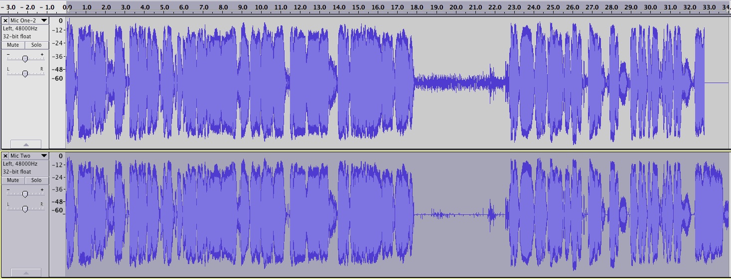

[Grovel] No - it's MY mistake. I had the mics the wrong way round for some reason. A thousand apologies.[/Grovel]
I downloaded them again (this time in the right order) and checked. Here's a screen shot in Audacity
(I dumped one of the stereo channels (R) in each for clarity:

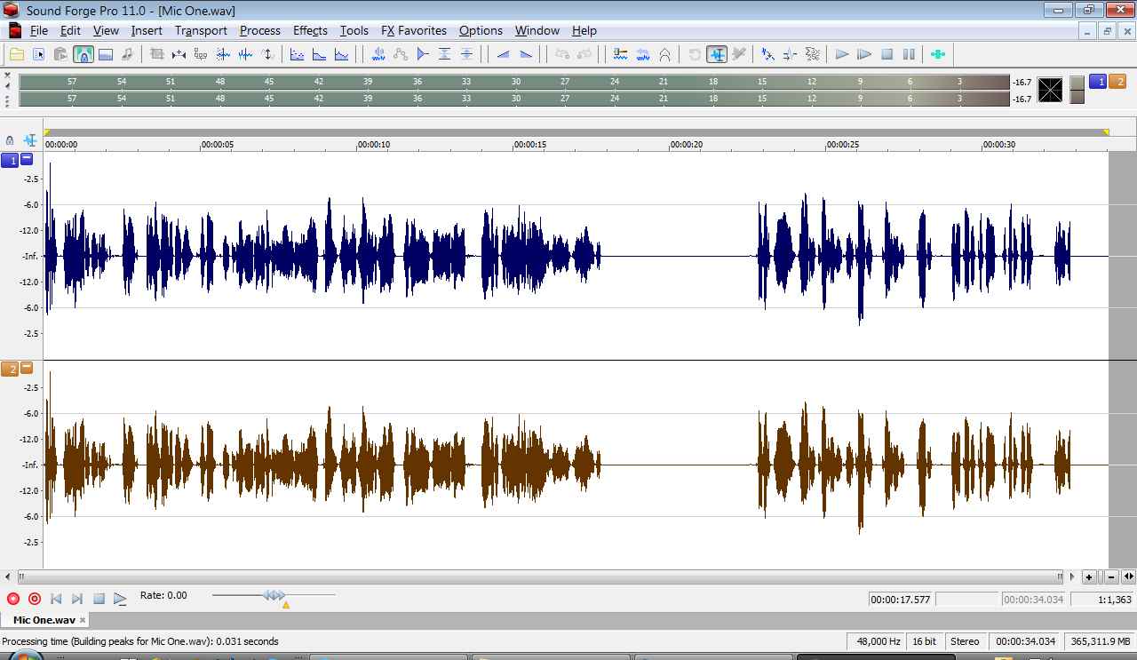

Re: Which Mic? Please listen.
That's a strange looking waveform Colin. Looks like it's highly compressed (dynamic). Could be just the Audacity display.
Here's what I get:
http://www.dvinfo.net/forum/members/...-sf-11-pro.jpg

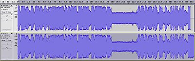

Colin, You did use dynamic compression on that file, right. That was the first thing I noticed on your screen shot. Those files are dry, straight, from the camera. Mic, XLR, Sony pre-amps. I considered recording audio outside of the camera to avoid the Sony pre-amps. But look what mics I am using anyway. Overall, the recordings are good enough to work with in post. Nothing big to repair, just normal sweetening.

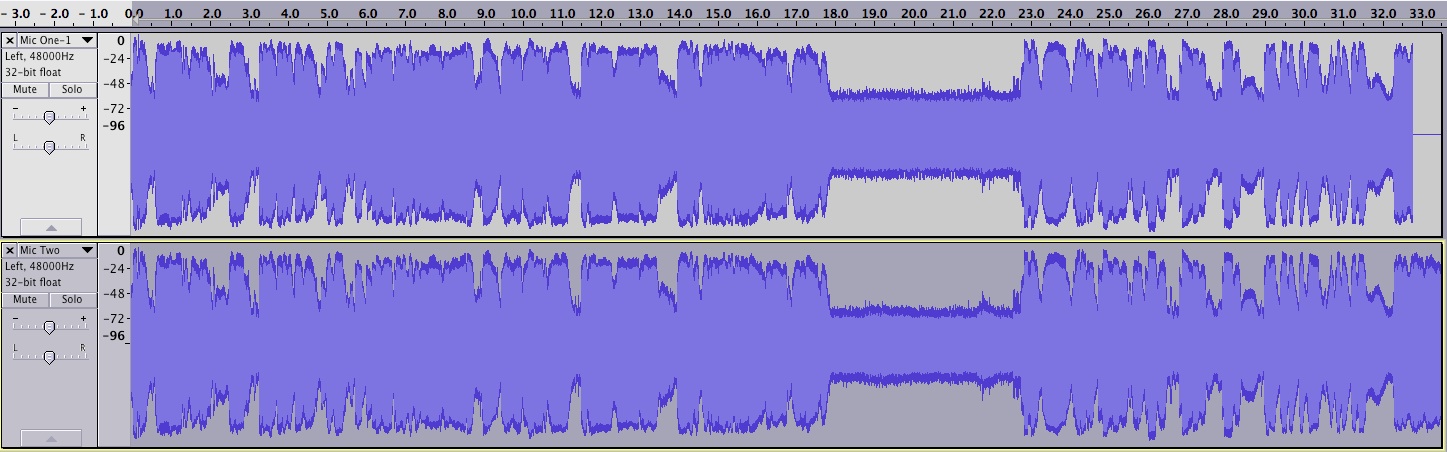

I had set the Audicity display for a larger than usual bit depth (16 bit) to look at the noise floor.
Here are the same files with the display set to 10 bit:
