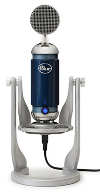

Thank you Steve, will do another session with a different orchestra on Tuesday evening. I was looking at some other Pro mikes which seem to have a round bubble on top (see pic) and they are used in the upright position, hence my original question.

Mic's come in two 'flavours', side-address and end-address. The mic you linked to is indeed a side-address mono cardioid. The Zoom's MS capsule in actually two mic capsules in one housing (one cardioid, the other figure 8) and the manual illustrations suggest it is end-address along the body of the recorder. Would be nice if they said for sure. The manual does suggest that you can use the mid capsule only as a cardioid mono mic for interviews, etc, so one way to maybe find out is to listen to the mid mic's signal signal only while pointing the mic at a sound coming from a single point source, as you point the mic at the source the sound should be loudest while pointed away it will be softest. See if the sound is loudest when the axis of the recorder is pointed at it or when the axis is 90 degrees away from it.
