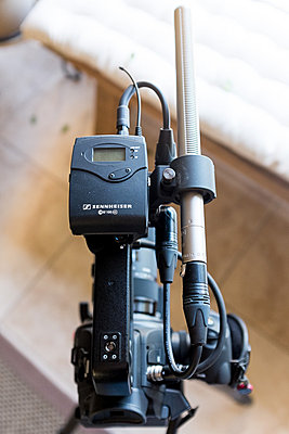

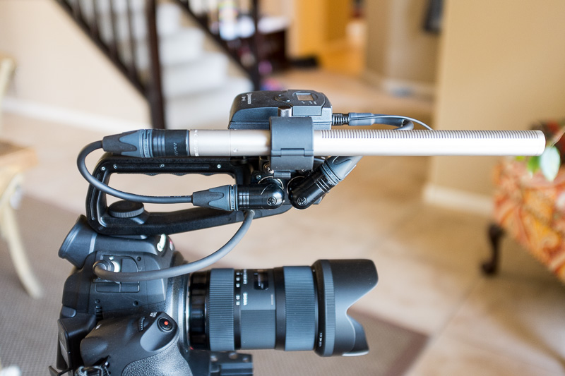

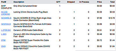

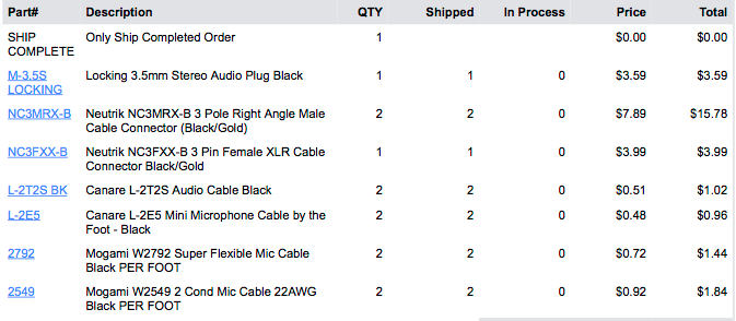

I just made some custom XLR cables for my Canon C100 to connect on-camera shotgun and Sennheiser G3. I got the XLR connectors and cable from Markertek for under $30 and it took about 15 minutes to solder each cable. It's really easy to do and there are a ton of tutorials on the internet that show you how to solder XLR cables. $70 is too much considering that even using the best connectors and cable the materials alone would cost around $15.
