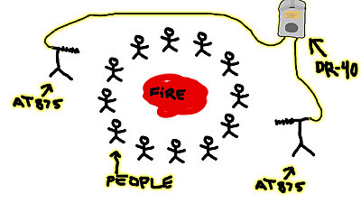

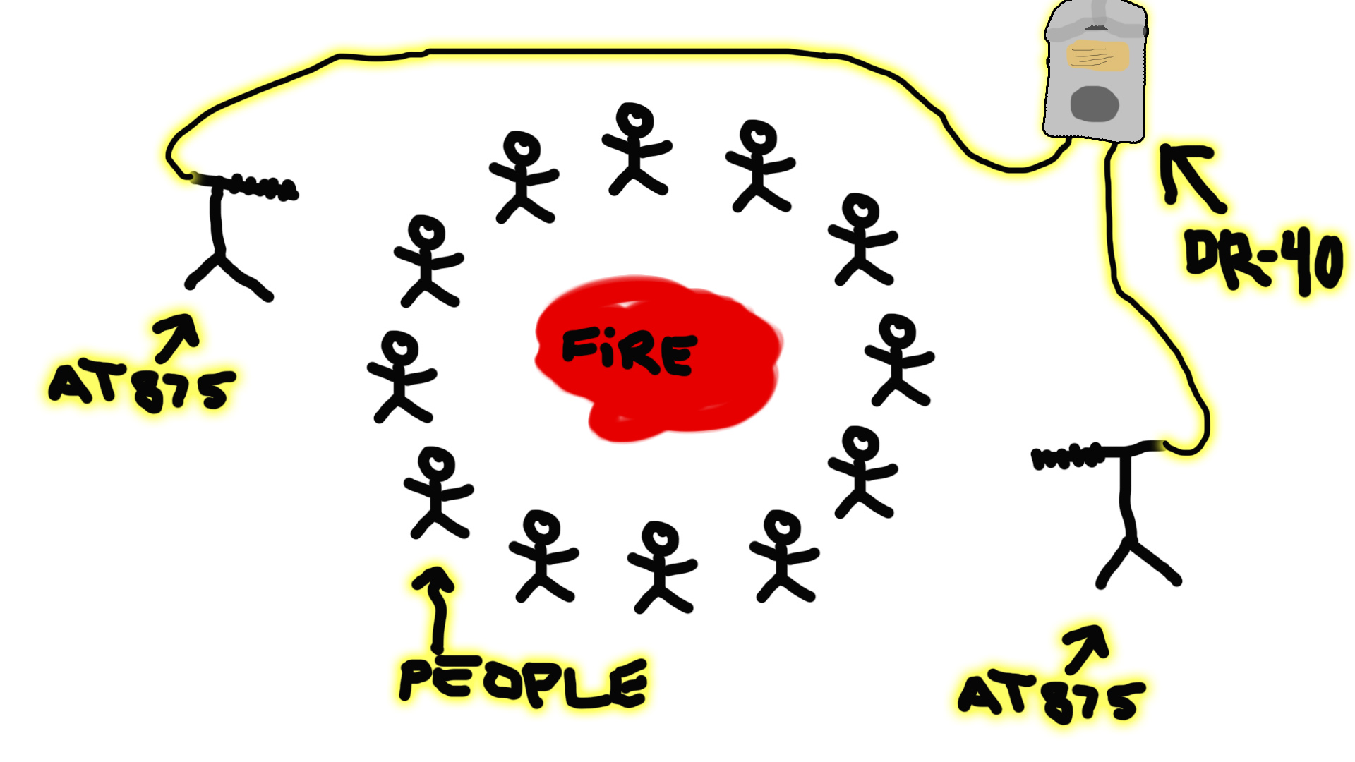

Here's one possible solution (with handy illustration) for ya...
Get a Tascam DR-40 and TWO of each of the following:
Audio Technica AT875
Audio Technica AT8314 50' XLR cable
Audio Technica 8471 Isolation Clamp
Auray MS-5230 Mic Stand
Slap it all together, and shoot across your group from opposite sides, offset as seen in the attached professionally illustrated illustration. It's a bit over your budget, but it's one of the few setups that will work with your rather restrictive restrictions.
Bryan Cantwell is offline   Reply With Quote

Is that any better than some Zoom H1s/Tascams sitting spaced-out within the circle? Is the point that the downward-pointed boom mics would isolate the sound locally
I was thinking a set of two Zoom H1 on opposite sides wouldn't be too bad to download/maintain/and sync.
Thanks for taking the time to draw that, nice colors :)
My professional documentary friend who did footage at our school last year in these conditions told his stand-in shooters to either have people pass around a lav mic when they spoke, or to get inside the circle and get right up in people's faces with the cam/shotgun (although there goes my ability to know I'll always have my wide camera shot to use, if I'm right in the middle of it).
I was in the program he was taking, and the lav-mic passing wasn't great. Killed the spontaneity of what was happening a lot of the time. And people didn't do it 40% of the time and just talked.

I used Bryan's multi-mic solution with the 3 Zoom H1s I purchased. With big cheap (25$) windmuffs on them, I split our circle of sitting people into 3 sections, with a Zoom facing out from about 2 feet away into each section. Fire was in the middle, and the Zooms act directionally, so pickup was great, have 3 tracks to pick from or sync (not sure how that would work with phasing, but I only ever need one at a time).
Only issue was a couple of the Zooms being a little too close to the fire. Will keep them further out next time.
