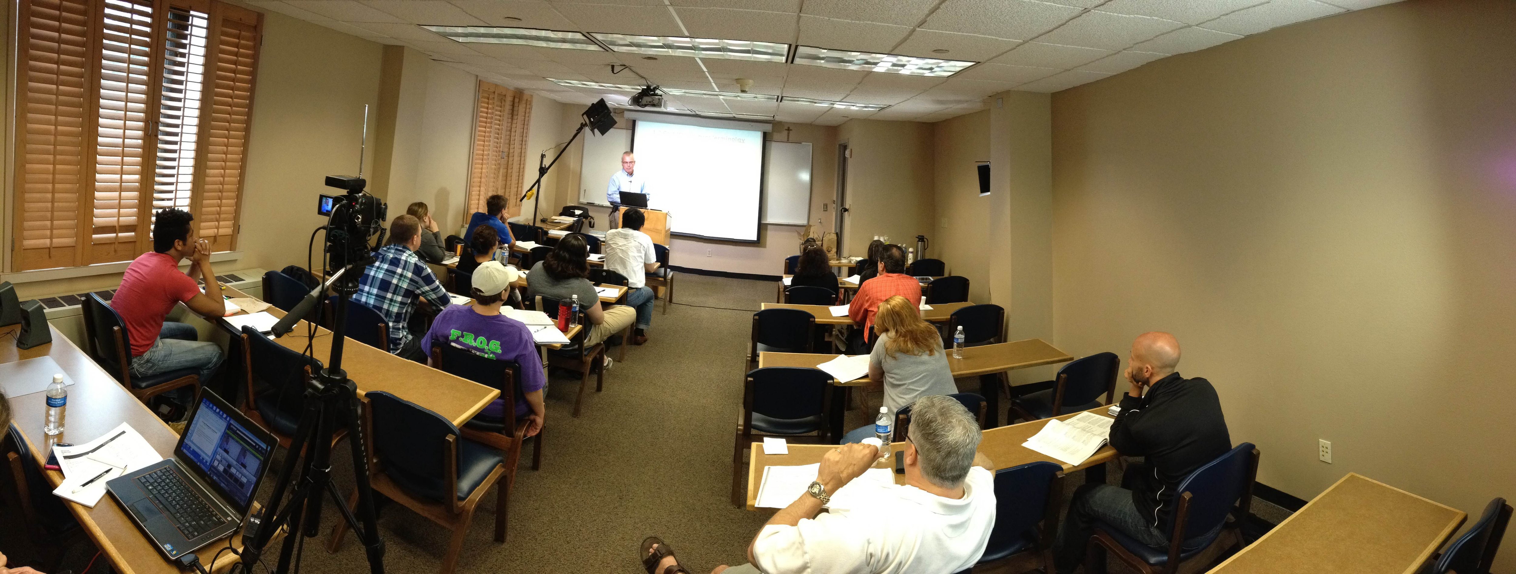

By the way, here is a picture that I took earlier today of my work environment that you can refer to -- you'll notice my little station there in the back with the camera and PC:

(By the way, your stand light is really washing out the screen. I hope the presenter isn't trying to use any projections! And I thought you said the participants were all using laptops ... I don't see any in your photo.)
