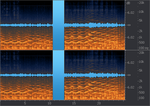

Jim, this is probably caused by the faulty recorder or the memory card. Try reading the same stuff from the card again. The problem is a digital skip in the file. It can be restored like this with a skip correction and some RX: NoiseRestored.wav.
If this file is valuable to you, I can fix a few more of these — just send them in a PM.
(click to see the animated result)

Molodets!!! What program did you use to do that?
Old June 25th, 2014, 01:07 PM   #21
Location: Moscow, Russia
Posts: 10
Re: What on earth bit me?????
Just a text editor to delete a byte of binary data. Then RX to fix the clicks at the boundaries.
Alexey Lukin is offline   Reply With Quote

Yes, it is quite important. From what I can see there are 3 or 4 in the Tchaikovsky Symphony # 5 and 1 in the Piano Concerto #1. The pianist flew from Japan for this concert. So it was rather a big deal.
I can send you the problem spots from the symphony, but the pianist has the original file for the concerto in Japan with her so I'll have to ask her to send the disk back to me.
Could you explain a little more about how you repaired it? I use RX, but how do you find which byte of data to erase? If I can understand that I can probably fix the problem myself instead of bothering you.
Thanks again
Old June 25th, 2014, 03:08 PM   #26
Posts: 10
I have just deleted a random byte closer to the beginning of the file. This has damaged most of the file, but repaired the previously damaged section. Then I have pasted the repaired section into the original file and RX'ed the transitions. I don't mind doing 3–5 more of these if you don't have luck with other spots.

I've tried it and it seems to be working successfully so far. 3 more to go
