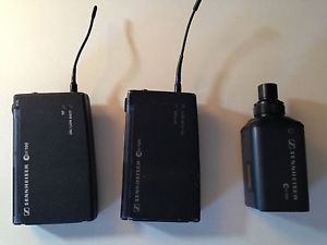

Hi everyone.
I've been trying to get my Sennheiser EW 100 G3 Wireless System to work with a Tascam DR-40 for over an hour and I can't get any levels on the DR-40.
I tested the DR-40 with a direct XLR/cable connection to an MD 46 and it works fine, good levels, on both L/R channels. The internal mics were fine too; did a record using 4 channel and only those mics recorded sound.
I also tested the MD 46 and the Wireless System (handheld plug, lav, receiver) connected directly to my camera (well 2 cameras, ex3 and a black magic pocket) and the sound comes through fine, good levels, etc.
Of course, I really want to run the mics through the DR-40 (also using the dual recording -6 db for safety) and then on to the camera but, I cannot for the life of me figure out why I can't even get levels to show up on the DR-40.
The units are old on the sennheiser system, so I know the firmware is ancient at 1.2.2 but, aside from that and I'm not even sure if that's a problem - I can't figure this out.
Can anyone shed some light on this?
Many thanks!

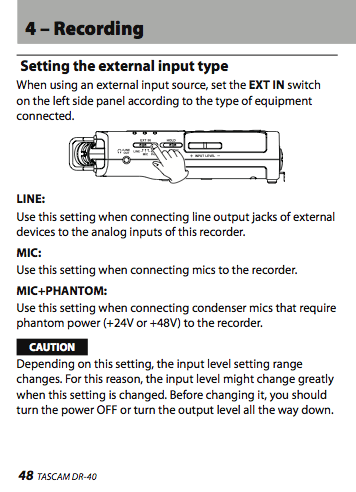

I assume you are using the Sennheiser cl100 XLR cable correct? Is the External Input Type switch on the DR-40 set to MIC as per the user guide and input to External?
Are you using the 1st, 2nd or 3rd generation Sennheiser?
Sennheiser G3 to Tascam DR-40 - Help!-screen-shot-2014-07-17-11.04.57-pm.png

Hi Les.
I'm using the mini to xlr cable and yes, the DR-40 is set to the mic (middle) position. I believe my G3 system may be a first generation as I've had it since 2010 - though I'm not sure; maybe I should have posted the model #s or info from the back label. The transmitters are set to -18db and the receiver is set to - 12db. I feel like I'm missing something simple!
Also the DR-40 is set to ext 1-2 (though I have tried ext 1 and independent) with no success.
