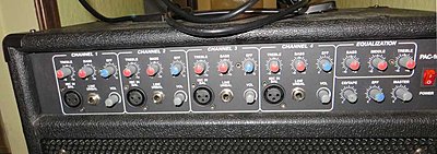

Last ceremony I had a small sony ic recorder with lavalier mike attached to a microphone stand just below the handmicrophone, it recorded well throughout the ceremony but at some point the priest takes the handmicrophone from that mikestand (which was connected to a mixer see image below with xlr) and when he placed the handmicrophone back into the mike holder on the mikestand he grabbed the mikestand with one hand and he very briefly touch the lavalier mike I had attached to that. At that exact moment (I have a visual confirmation from one of my camera's) the lav mike dies, there is a loud cracking sound and after that there is only deadsilence.
I have just tested the sony recorder and it still works fine with other lav mikes, only the one I used doesn't work anymore? Anyone know what might have happened that caused that lav mike to fail?
