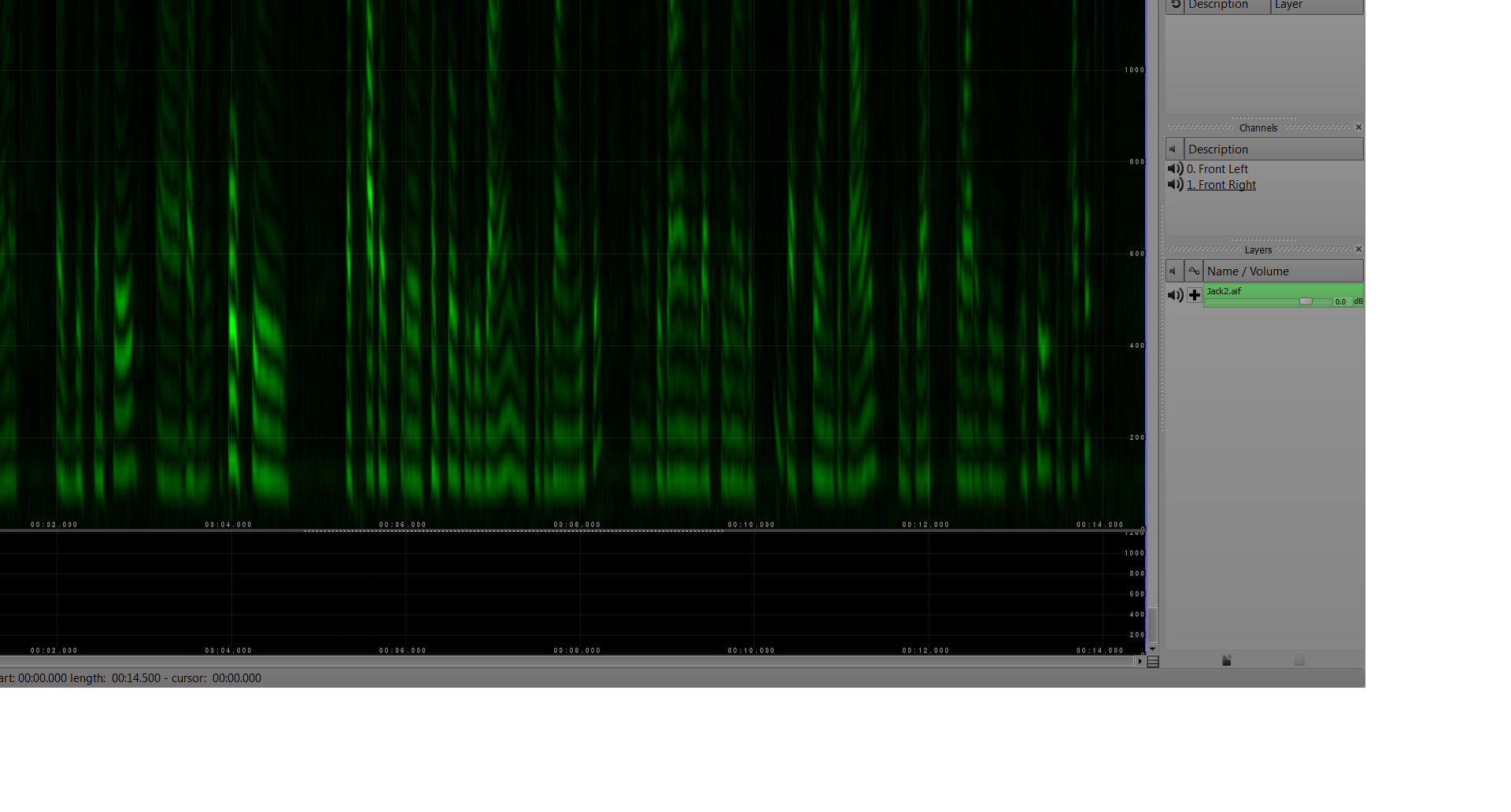

Here's a spectrogram of lower frequency region.

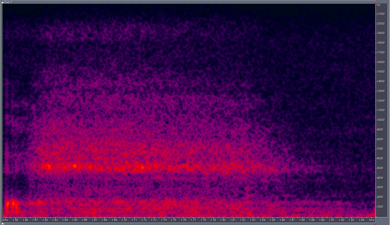

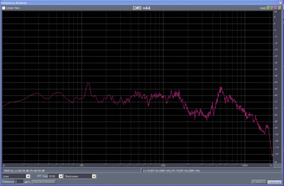

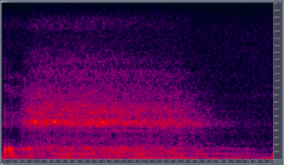

EDIT: Are you sure this is raw? The camera literature specifies a 48 kHz sample rate. The latest file (Jack2.aif) appears to have a 44.1 kHz sample rate. If both of those statements are correct, and "Jack2.aif" is actually a converted file (not raw), then can we be sure that there wasn't some other transform that might have changed the audio quality?
Need help removing hum-jack2.aif-scan01.gif   Need help removing hum-jack2.aif-spectral01.gif

My concern is that there seems to be a lot of attenuation between roughly 2kHz and 4kHz. (I say that because the frequency content of the file drops off abruptly around 2kHz, but then seems to come back up around 4kHz with a bit of a peak around 5kHz.) Since the file was obviously "processed" in some way (as indicated by the change in sampling frequency), I wanted to be sure that you hadn't inadvertently applied some EQ in the process.
Of course I can't prove that those frequencies are really attenuated, compared to the actual live sound. But based on what I hear (comparing your "raw" file to my "adjusted" file), and compared to what I see in the two visual representations of the file, it certainly seems to me as if something went awry.
