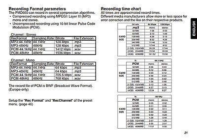

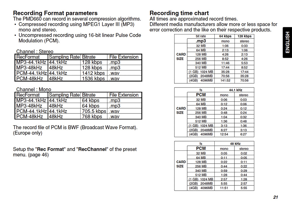

Sorry it took me a while to get back. I am using a Marantz PMD 660. I've attached the page of the manual where it gives recording times. I've not run into a problem of running out of disk space, but as you can see, or maybe it's just me, with the 4GB card @48kHz it LOOKS like 5 minutes and 55 seconds. I'm now thinking 5 HOURS and 55 Minutes??? The page wasn't clear enough for a novice such as I am.
Can someone clarify this? If it is actually about 6 HOURS then there would be no reason to record anything other than the highest quality.
Jonathan

Yes, that's hours / minutes.
'With a 4GB card @ 48k/16bit: 5 hours. 55 minutes (stereo), 11hr.s 51 min.s (mono)
@ 44.1k: 6:27 (stereo); 12:54 (mono)
The mono mode would be recommended for spoken word and other single source recoding... (in the mono mode, for line level, the tip terminal of a 3.5mm TRS or mono plug.. for mic level, the left XLR input.
48kHz. is standard for audio for video, 44.1k for audio only.
As I recall, the 660 does not have a 24 bit mode.

Re: What format do you record at?
Thank you Rick!!!!
Something was off there and thanks for clearing that up. And yes, the 660 only does up to 16 bit recording.
I've used this mostly hooked up to my Shure FP 33 for two to three person interview type stuff, so I'm thinking with the stereo it would be one more level of control in post if I mess something up. I can always convert to a single mono track.
Jonathan
