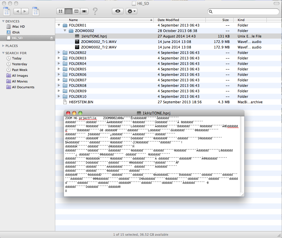

I am not absolutely sure, but I am inclined to think that the Zoom will not recognise any other naming format for its folders or files. I changed the name of a project to "1KHzTONE" because I keep it permanently on the H6 and as you can see the change only affected the .hprj project file and not the audio files themselves.
Using the H6 in 'SD Card Reader' mode and looking at the files from my iMac this is what I see (pic attached).

After having a look at the manual, it seems quite clear from page 25 that when you use the project name set to "date" as you have done, the audio files remain named ZOOM000x
Any computer should see the file creation date of the audio files so you could import the whole folder by drag and drop then do a get info on each file and copy and paste the time/date into a new filename. If you are importing via audio or video editing software there might well be problems if there are several files with the same name from different folders on the H6.
