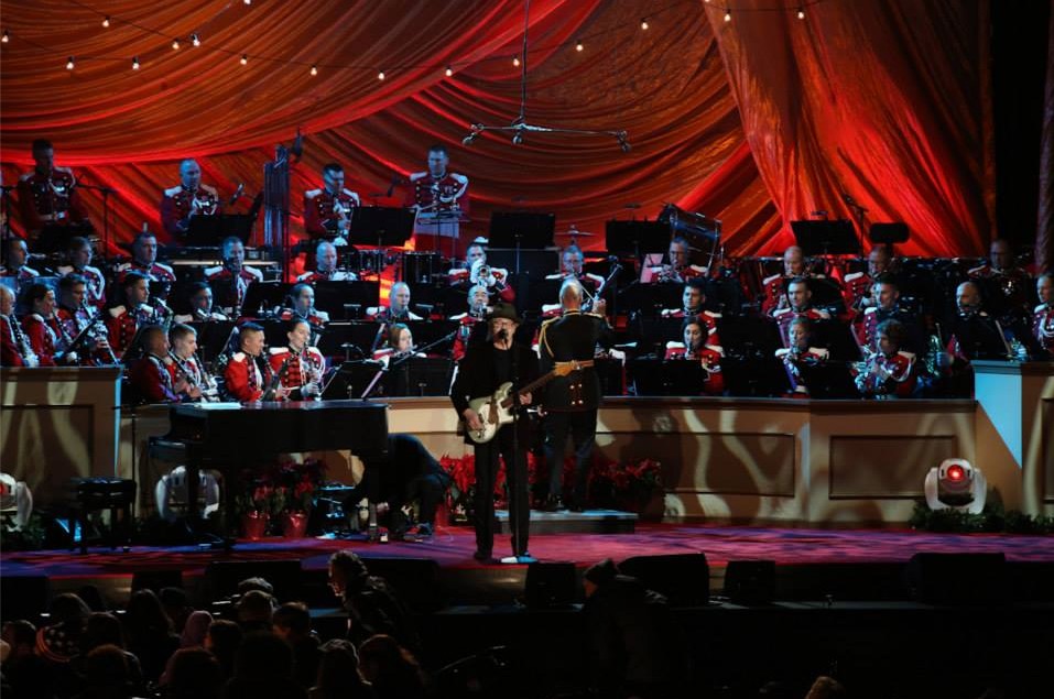

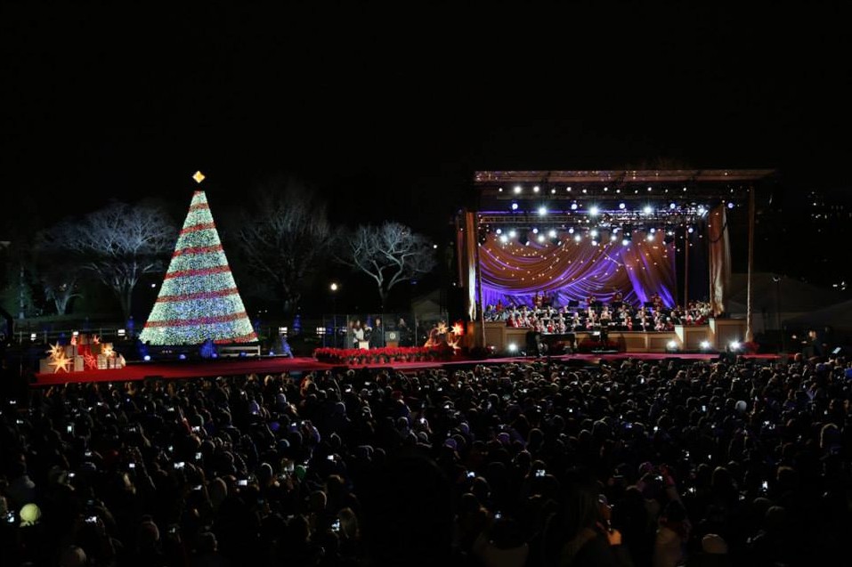

I'm a bit too late, but yes, you will find trees outdoors. Here is the National Christmas Tree Lighting in Washington DC two weeks ago.
Decca tree outdoors ??-cba-2014-12-21393.jpg   Decca tree outdoors ??-cba-2014-12-21394.jpg

Christian. Better late than never. Now that's not the volcano state but presidential Washington City isn't it. The suspended array of mikes in your image is probably what the soundies should have had over the College kids choir instead of miking them from the front with a row of three on stands.

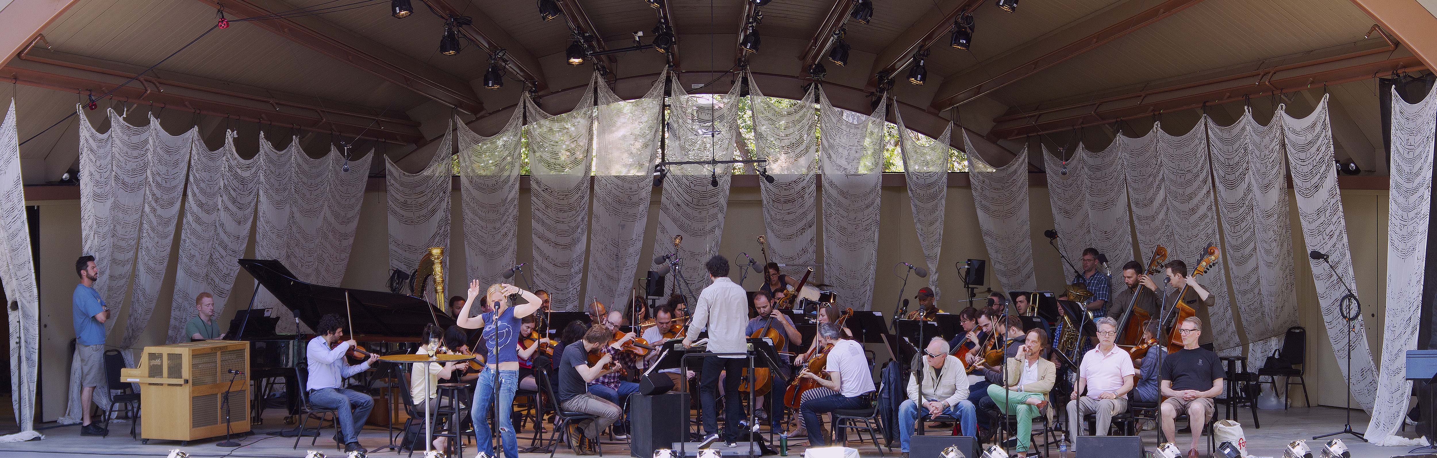

Missed this thread earlier... I use trees pretty regularly when working outdoors with large ensembles. This tree uses DPA 4006 mics with 50mm balls on the ends. It's from a festival that I do the sound for every summer that involves high-end recording and amplification of major classical artists.
This is a picture of a rehearsal of the Kurt Weill 7 Deadly Sins with Storm Large, Hudson Shad and The Knights.
--Ben
