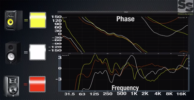

You can hear them compared to the Yamaha HS5 and KRK RP5G3 monitors here:
The above comparison is iconic. On one end, we have the reserved Yamaha which has little bass. This follows the family line of the classic NS10. On the other end we have the hyped KRK. IMO, the JBL shames them both.
The Yamaha not only lacks bass, it has a large mid peak around 1K. (See the attached thumbnail at the bottom of this post.) Some describe the sound as "boxy", likely due to this 1k resonance. We can see that this is not likely a room effect as the other speakers have totally different responses in this range. Some say that the HS5 sounds a bit ugly yet revealing, allowing them to cut unwanted frequencies, but I think they're just hearing and compensating for this unwanted peak.
The KRK sound is quite the opposite. It's scooped. The bass isn't all that deep, so there's a big peak at 125 Hz (boom, boom, boom), and troughs at 1k and 3k. Frankly, it sounds like somebody threw a blanket over it.
The JBL sounds natural and reasonably deep without being boomy. Looking at the chart, the three competing monitors do their own thing from about 600 Hz to 12,000 Hz, so the room is likely not affecting things here. The JBL is clearly the flattest in this region. Below 600 Hz, we have to look for correlations to mentally remove the effects of the test room. Common points are the peaks at 400. 250, 175, 125, and 60 with troughs at 500, 300 and 100 or so. If you mentally adjust for these, the JBL appears to be really flat and really deep with only a slight mid-bass emphasis. (BTW, the peak above 16kHz could be hype or hiss. I can hear some slight noise when I put my ear close, but not at normal listening distances.)
