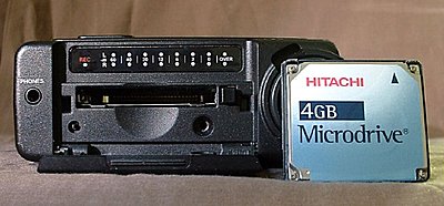

Old April 14th, 2015, 08:13 AM   #9
Location: New York
Posts: 2,044
Re: Monitoring Audio, FP33, recorder D800 AGAIN UGGGH!
When I had a 660, I used a 4GB Toshiba CF Microdrive and a Sandisc and both of which worked perfectly. As I recall, they were regular Class 4 (slow) cards. It's possible that Marantz doesn't like the fast cards.
Additionally the CF cards should be FAT16 or FAT32 and re-formatted in the recorder prior to use for the proper allegation table/table of contents.

Old April 14th, 2015, 09:27 AM   #10
Location: Eugene, Oregon
Posts: 222
There used to be a list on Marantz's web site of the cards they had certified as good. I have tried several times to Google it and can't find it any more. It seems Marantz may have erased all references to the DR660. In any case, I have also used a SanDisc 4G card quite successfully. I also had a different brand that would record fine, but would not transfer the data through USB, so it really does matter which brand you use. If I ever come across that list of approved cards again, I will try to post a link.
Have fun!
Rob
Rob Neidig is offline   Reply With Quote
Old April 14th, 2015, 10:07 AM   #11
Location: New York
Posts: 2,044
Yes, D&M Pro used to have a list of preferred CF cards for the 660. Could not find it either.

Rick, You made me laugh with the photo of the Micro Drive. I have two of the IBM Micro 1gig drives from way back then. For those of you not familiar with them they are called CF II. That is not flash media, there actualy is a spinning HD inside that damn thing! Pretty unbelievable. I think I paid $300.00 each for mine, ouch.
Steve
www.CorporateShow.com
Old April 15th, 2015, 09:10 AM   #13
Location: New York
Posts: 2,044
Yes, it was like a small HD. I forget what it cost, no where as cheap as today's media fo' sure. Never had any problems with it and I recorded hundreds of all-day legal educational seminars with it. I mixed on the fly and recorded in the mono mode which gave me up to 13 hours record time @16/44. The photo is from when I sold the 660 on eBay five or so years ago.
