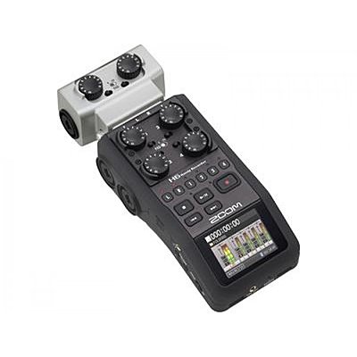

The H6 has six true XLR inputs with the proper input adapter.

I have been using a Zoom H6 several times a week for 18 months now, and have been pleased with its reliability and performance under differing conditions using external mics.
Clearly the H6 is not a professional quality field recorder, but it may well do the job for you on a budget perfectly adequately. It is a big improvement on the infamous H4n in terms of noise and much more suited for recording 6 channels than 3 separate recorders or an R16.
Note however that there is no phantom power available with the XLR module which replaces the internal mic module on the R & L channels. I use a separate mixer on the occasions when I need 6 or more 48V mics.
If you can work around the phantom power being on 4 channels only it is certainly worth considering.
I do find the extra 2x -12dB backup channels derived from the L & R inputs quite reassuring though I have only once had to resort to actually using the safety net recording channels in the delivered product.
