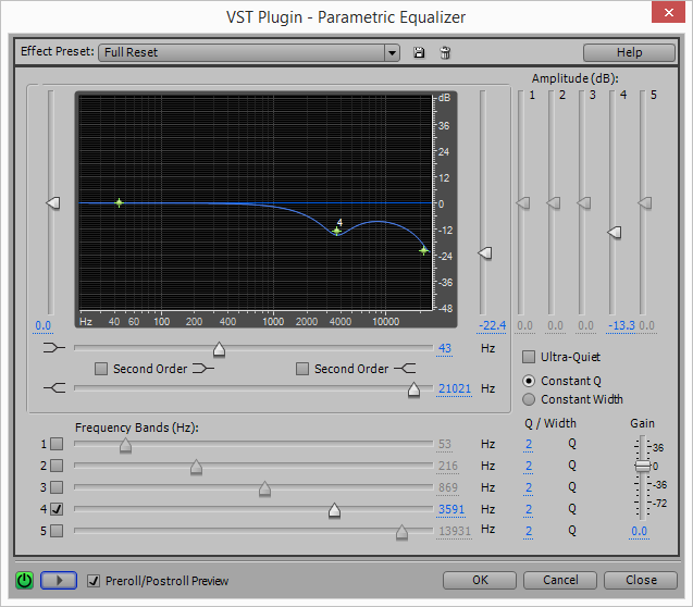

Hi, Kathy.
I experimented a bit with the parametric EQ in Adobe Audition, and this is my first-pass attempt at equalizing the dialog.
First, I selected a part of the timeline that had something approaching a complete paragraph(!) I picked the section from 1:00:01 to 1:00:46. You can't EQ the on-mic subject and the off-mic interviewer together, IMHO.
Then I clicked "Effects" in the menu, and then selected "Filter and EQ", and picked "Parametric Equalizer", to bring up the window shown here.
First, I rolled off the high-end which seemed quite excessive even to my old, tired ears. I dragged down the high-frequency control to -22.4 dB as shown.
Then I turned on the #4 filter and dragged it to around 3590 Hz, and down to -13.3 dB to try to tame what I heard as an annoying resonance.
Of course, you use the "play button" in the lower left corner so you can hear the track while you are playing with the EQ. And you can turn the EQ on and off using the green button next to the "play button".
Now this is only what I heard with my ears and my JBL LSR305 speakers. Feel free to turn on other frequency bands and drag the nodes around to "season to taste" for yourself.
I sometimes drag the EQ points UP above the center line to emphasize the frequency just to try to make it "worse" so that I can "tune" it to the offending frequency/band. Then I drag it DOWN to filter it out of the track to whatever degree seems appropriate.
Certainly this is all VERY SUBJECTIVE. I tried to demonstrate HOW I did it rather than declaring "this is how it should be done" because that is ultimately your decision (and your client's).

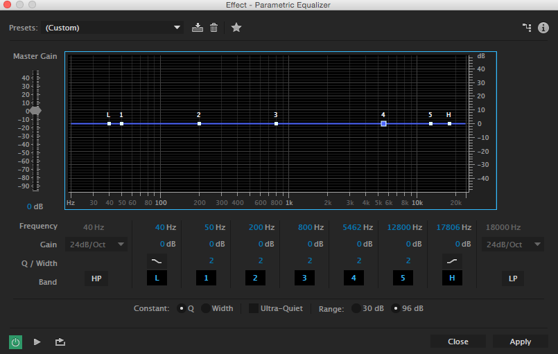

Hi Richard
My Parametric Equalizer in Adobe Audition doesn't look like that. Is this some kind of plugin?
Kathy Smith is offline   Reply With Quote

Old June 12th, 2015, 02:14 PM   #15
Join Date: Oct 2010
Location: NY, NY USA
Posts: 527
Re: Audio improvement help
Originally Posted by Richard Crowley View Post
It is the one that came with Audition. I have not installed any extra plug-ins.
What does yours look like? Doesn't it have the same basic functions?
The window may not look identical, but the basic function has been the same through almost all of the versions.
Hi Richard,
My Parametric EQ looks like this and it doesn't say VST plugin like yours does.
