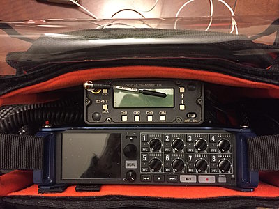

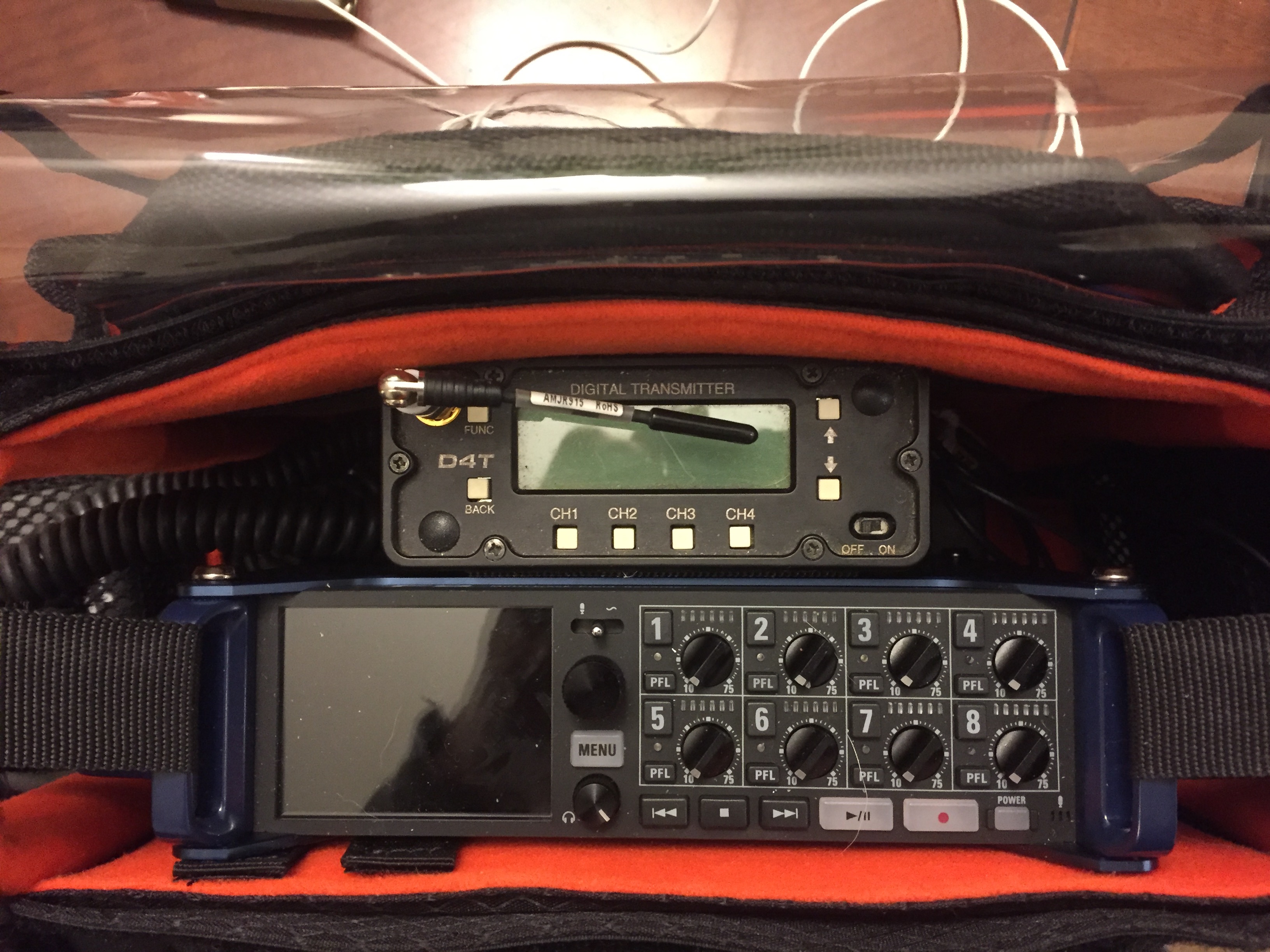

I recently recorded a sample of the RODE NTG-2 going through the Zoom F8. If you'd like to take a listen it would give you an idea as to how it sounds with your RODE NTG-1 (same capsule) and the video goes over the features/benefits.
Also here's what the F8 looks like in the Stingray bag. There is enough room for the 2 RODELink receivers and even a BDS with NP1 or Anton Bauer with D-Tap should you decide to go that route.
Trying to put together a general purpose audio kit - advice?-zoom-f8-ktek-stringray.jpg
