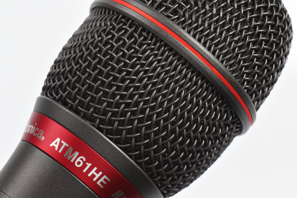

I've never tried the ATM41a, but I do love the pair of higher output neodymium hypercardioid ATM61HE (High Energy) that I have and use a lot. They have about twice the output of the regular dynamic Artist Series mics. See the photo I shot while playing around with my macro lens and strobe setup:
I say try them out for yourself. The AT gear of that period and those product lines was very good, especially for the price point. I've always preferred the generally flatter AT dynamic vocal mics to their Shure dynamic equivalents, but I do a lot more recording than I do band PA work (very, very little really...)
Old Audio-Technica Mics, Your Thoughts?-atm61he-low-res-1000h-4x6-img_2783.jpg
