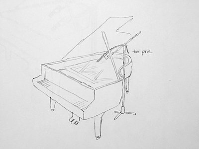

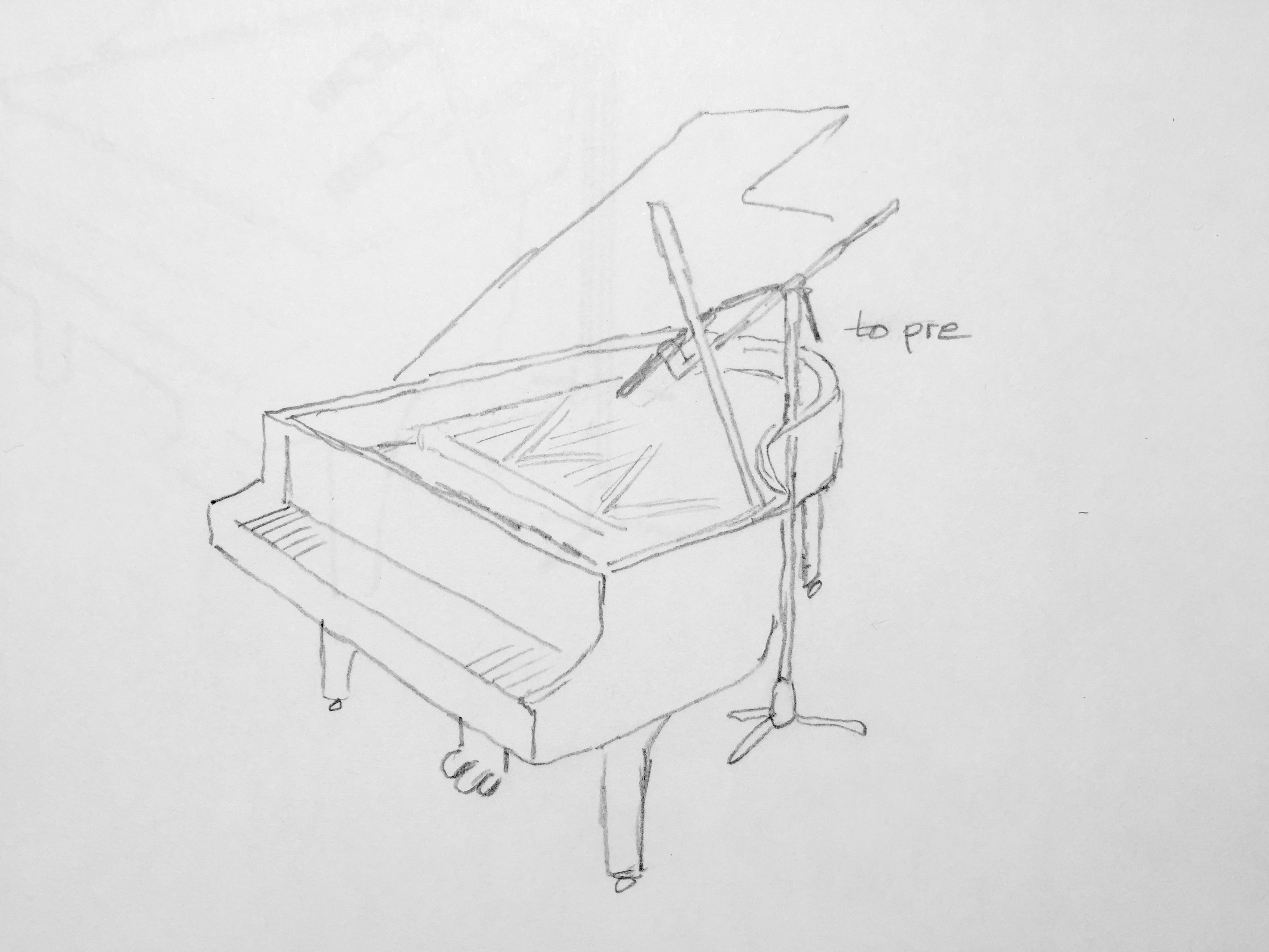

There is a piano recital that I’ll be recording this Saturday, June 11, and I’m beginning to get a little nervous about it because I really need to raise the audio bar. The shoot will be a multicam with two cams but that’s not the problem.
The problem is how to handle the audio. In the past I’ve done a balanced mono recording with a Sennheiser ME-66 / K6 on a boom angled toward the board and run through a JuicedLink pre. The best performer who happens to have a really good ear has really liked the audio quality so far. However, the last recording was a year ago and everyone has really matured in their playing ability. They’ve matured but my audio kit and miking technique has not. It’s time to try and raise the bar.
While I’ve been thinking about what to do and, more lately doing some research, there are more questions than answers and time is running out. The recital will be in a modern church with a high ceiling, no fans, and, say, about 60 people. There will be only one piano and no other instruments or vocalists. The pianists will only be playing classical music.
The available mic kit includes the Sennheiser ME64, ME66, (but only one K6) and a RØDE Stereo Videomic, not exactly the choicest kit but it is what it is, at least for this year. In the past I’ve set the mic stand along side (but not touching) near the middle of the piano with the boom directed toward the middle and the mic slanted down toward the strings, slightly favoring the treble side.
With speaker tweeters, high frequencies are less directional than for woofers. Since a mike is sort of like a speaker in reverse so this is why I chose to favor the high end.
Here are my thoughts:
The ME-64 is more omni than the ME-66, therefore it might be better suited than the ME-66
The ME-66 can be placed further away therefore the difference between the highest and the lowest note strings won’t be as much.
The SVM is stereo so should provide more ambiance to the listener.
The SVM uses a mini cord to the JuicedLink pre while the Sennheisers would use XLR cable.
Attached “Mic Comparison” pdf file is what I have for technical info on the mics.
I’m open for comments with this kit but please realize that any use of a different mic is fine but will have to wait until after this performance (June 11).

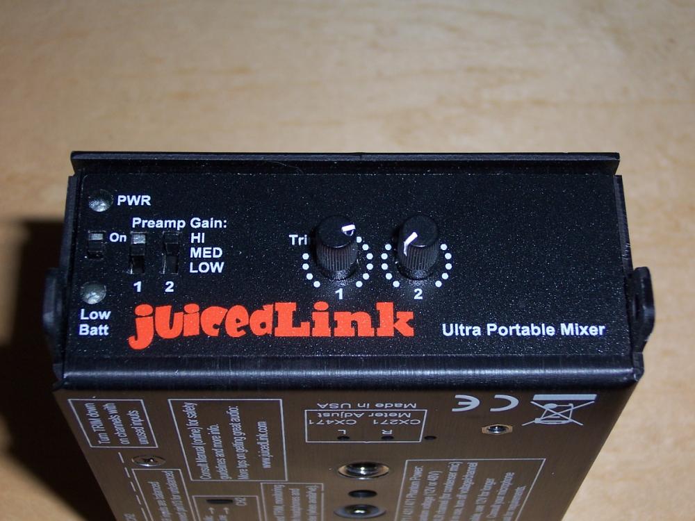

Hi Steven,
Originally Posted by Steven Digges View Post
How many inputs/outputs on your Jucedlink?
Inputs:
XLR x 2 inputs
3.5mm stereo x 1
Line level signal input attenuator x 2
Outputs:
3.5mm stereo x 1 output
L/C/R pan switches for each output channel
adjustable gain settings x 2
