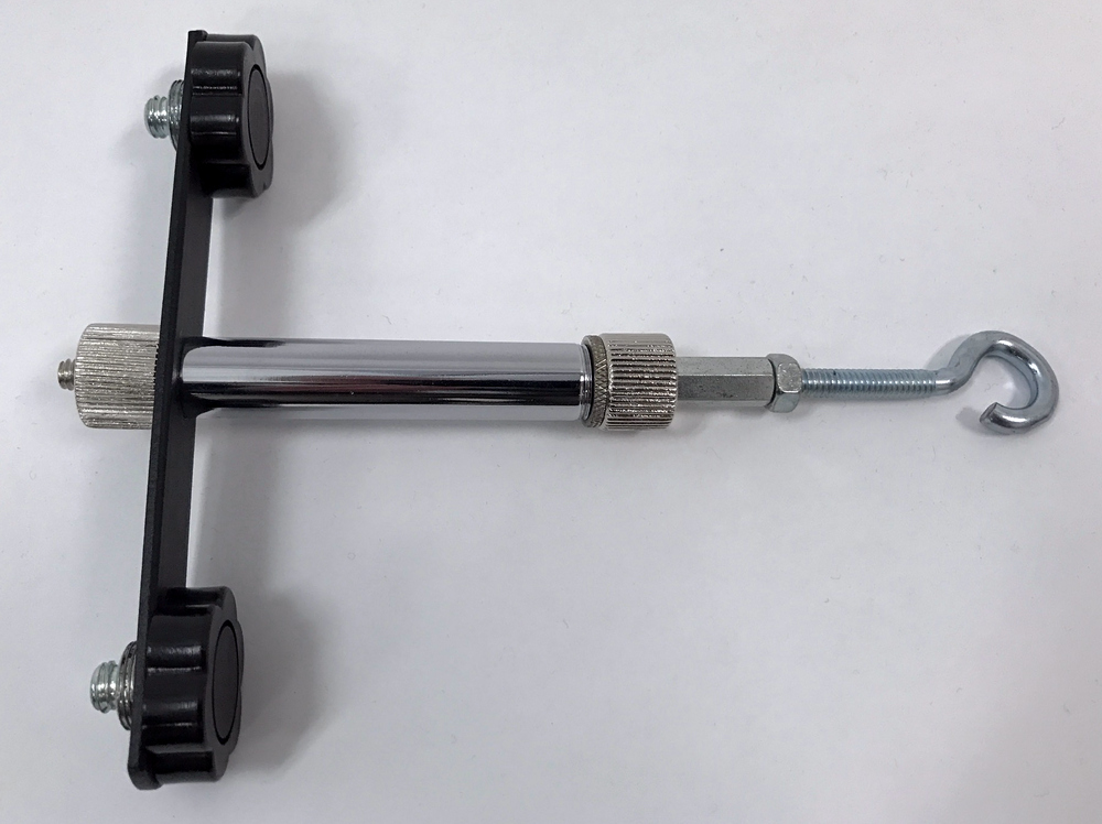

Does it have to look "professional"? I have used simple woven nylon cord to suspend the 4-inch mic post and swivel clamp removed from a table-top mic stand. It worked fine but obviously looked home-made. Essentially a DIY version of the Schoeps you linked.
If you are careful with the woven (not twisted) cord, using a new roll and un-roll it rather than un-coil it, it shouldn't take long to stabilize.
To work on a suspended ceiling without having to get above the tiles, I have used ceiling scissor clamps, female to female threaded adapters and either threaded hooks or eye-bolts that were spread open or a small section cut out to form a hook. I have seen now there are ready made loops to go on ceiling scissor clamps, but mine cost pennies versus dollars back in the day when I made 5 of them.

One other note, in my use the cord supported the mic and mic holder, and the XLR cable was anchored to a slightly offset location on the ceiling and not tied directly to the supporting cord.
So it was very easy to aim in rotation by adjusting location of the XLR cable anchor point and the rig never moved (unless someone bumped into it).
This method also reduced noise from vibration, because the XLR cable was only supporting its own weight and was slack enough to have a slight curve.
You could sometimes see slight vibration in the cord, but that was lost in the mount before it got to the mic, and couldn't get into the mic cable because they hung separately from each other by a few inches.
A stereo bar would be an easy addition to my system, you would just mount the stereo bar to the 4-inch micstand stud just as you would normally, except hanging upside down.
Jay Massengill is offline   Reply With Quote

I reassembled what I used to use and added the stereo bar (and an additional new and helpful adapter).
The only eye bolt I had handy had been sliced open to make a hook. If you want full security use a fully closed eye bolt.
I also added a 1/4-20 stud in the middle of the stereo bar so you can mount your action camera as well!
Use the micstand trim ring and/or the lock nut on the eye bolt to adjust the rotational position as needed.
