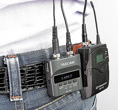

What do you think about this setup? The reason I ask is, I'm looking at another Senn G3 or maybe try this setup.

I have this unit, and other than a relatively low recorded level with my matchstick mic, I find them handy. The backup recording feature is a great boon, since you can't monitor your level..but I've never experience clipping because of the aforementioned low pre-gain levels. I do wish they offered more than a L/M/H setting, as I'd love to set the level manually, then have the security of a -6dB safety track.
Using it as a backup for a wireless is a smart move, since your sole point of failure then becomes the physical connection to the microphone (or possibly poor placement and rubbing noise). It's well worth the price. I believe the US spec'd model does not allow for this functionality due to some ridiculous patent infringement law, so if you can get the EU model (which I did), you'll have that pass-through capability.

I've had my DR-10L for about six months and have only deployed it a few times. I have one as a back up to my wireless lavaliere systems. I have a few UHF and and few of the Røde Video Wireless Lavs which operate at 2.5 ghz. The Tascam is pretty sweet little recorder but yes, the lack of monitoring means it is the last thing I will use. But like all of the other tools in the tool box, it does have it's place and is much better than not using any mic.
