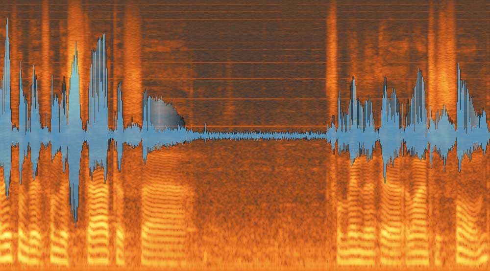

Definitely some harmonics in there.
Andrew

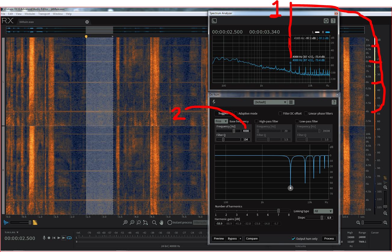

Sampling thru RX6 Adv, and using their Spectrum Analyzer I found a whole host rascals running 4k 6k 8k 10k and 12k.
http://www.dvinfo.net/forum/attachme...1&d=1500206291
I punched in 4k and removed 4k 8k and 12k. This left behind those 6k and 10k. I punched in 6k and got rid too.
Spectrum Analyzer is your friend!

Auto mode on the de-hum is also handy. :-)
