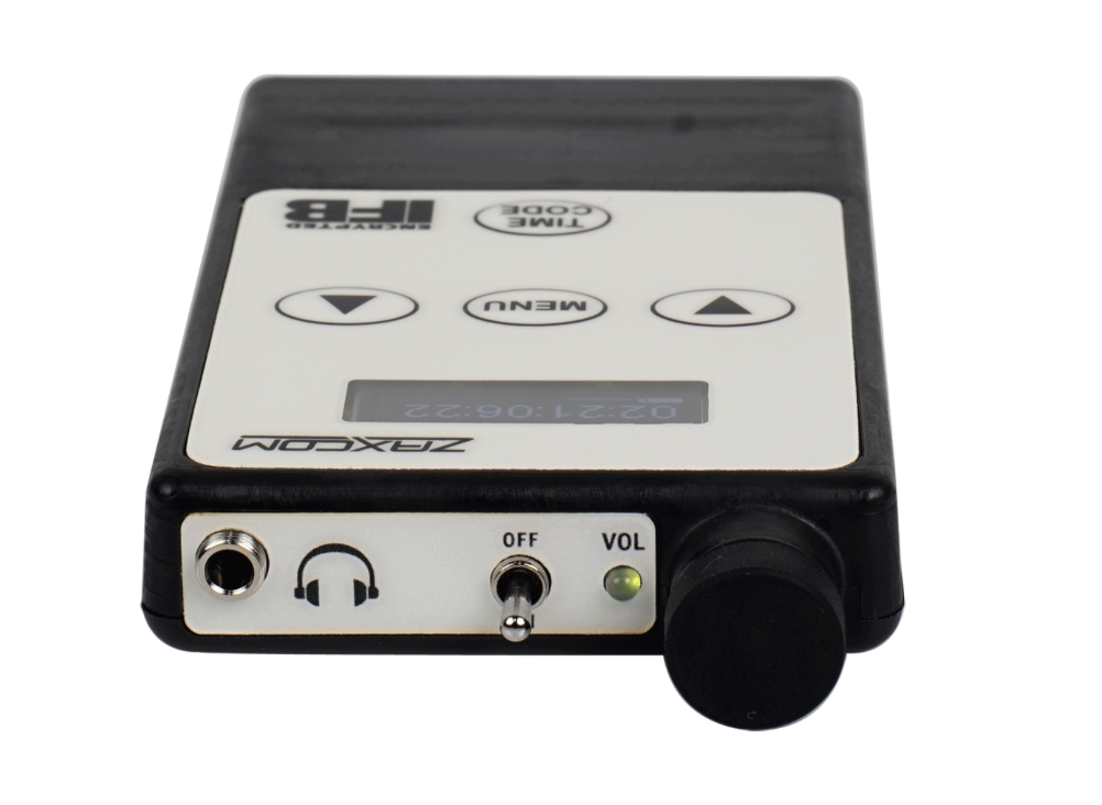

I didn't mean how to connect the mic. How do I connect the receiver to my audio recorder. Maybe the images they have on their website don't show the connection? See the attachment. Is the connection on the bottom? The image shows the top.

If that's the ERX3TCD TC/IFB receiver, it is more for monitoring an audio mix and displays/outputs LTC. Good for a scripty, general IFB duties or a cam hop for instance. It has one 1/8" stereo unbalanced audio out (HP jack) which 'could' be used to feed a recorder, though it's HP impedance (32ohm) and level. Not Ideal for feeding a +4 line level balanced input.
