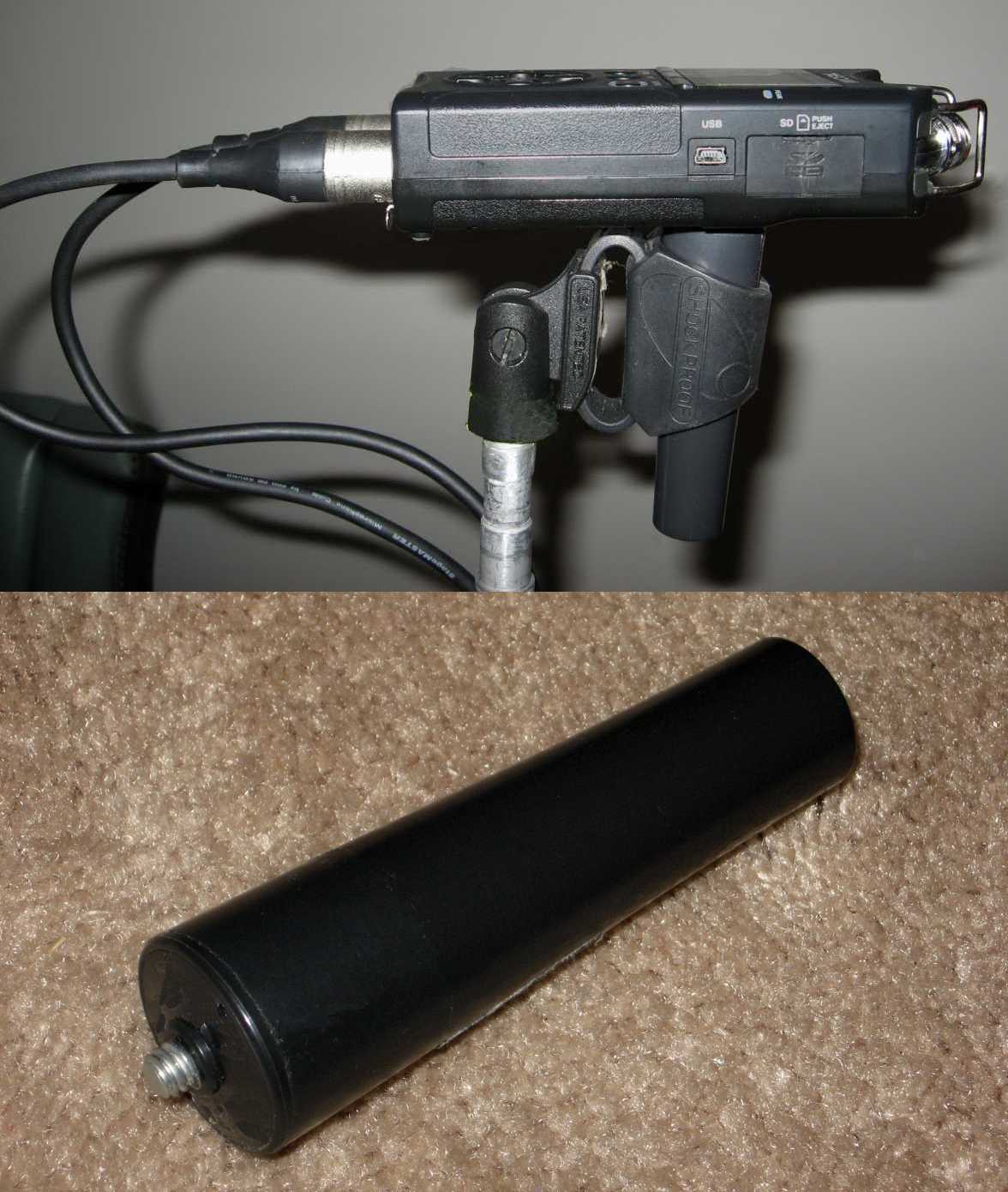

I use the H2's screw-in mic clip adapter.. which has the (standard photo) 1/4-20 stud that screws into the recorder (in my case, a DR-40), the other end is the same size/taper as a SM-57/58, which fits into a typical mic clip, The Shure A55M shock mount is too light weight for a recorder, so I use the heavier duty 25mm Olsen Windtech SP-25 "Shock Proof" (about $12 cheap). It works well to attenuate vibrations and such.

Im using the same screw in tappered zoom mic adapter. I was able to look up the olsen mic holder you are talking about. thx i’ll need to add that to my kit.
