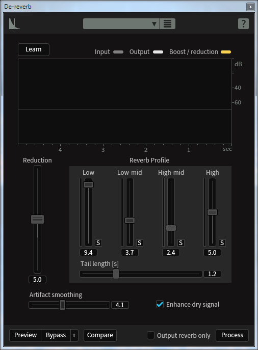

Here's mine thus far in iZo RX6 ADVANCED:
http://www.dvinfo.net/forum/attachme...1&d=1528698336

This is what I did:
1] In iZotope I used Spectral Noise removal to reduce the Ambient "mush" to reveal more of the ECHO and rendered out the file.
2] In VegasPro15 Normalised the Volume and applied my Invert Phase method/approach using Track Compression. Exported to iZo
3] Back in iZo I applied DeReverb and created my "First Scan" of the file and saved this as a First Scan Preset and Processed the file.
4] Applied a "Second Scan" of the processed file to 3] above and saved this as a Preset and Processed the file.
