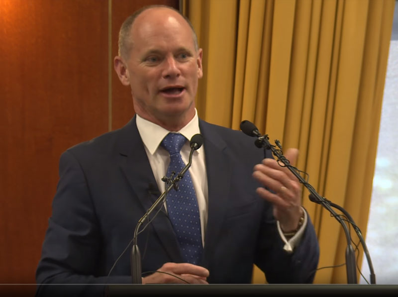

This is how the Australian news crews handle it. :)
Andrew
