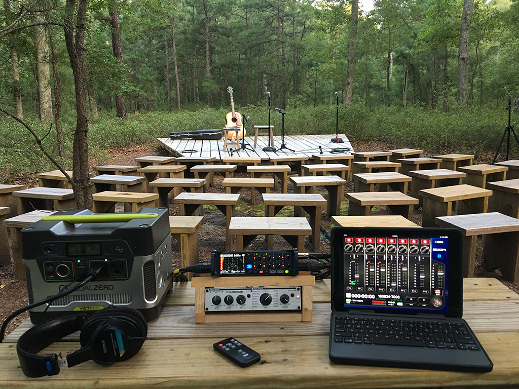

Just did a 6 hour shoot there on Saturday with my family and had a terrific time. The Zoom F8 really did a great job, I fed a stereo mix to the camera which generally sounded very good, but I will spend some time doing a better mix as I edit the footage.
For this application, it would have been nice to have the physical sliders and some of the other features of the Zoom L-12, but I got the F8 because it would be more versatile for other purposes. And I really liked the flexibility of creating custom patches for the outputs. I used the main output for the stereo feed to the camera, the sub output fed the stage monitors, and the headphone output fed a m-100 stereo effects processor looped back into two inputs for a nice reverb effect.
recording multiple mics simultaneously-soundboard.png   recording multiple mics simultaneously-kids.png
