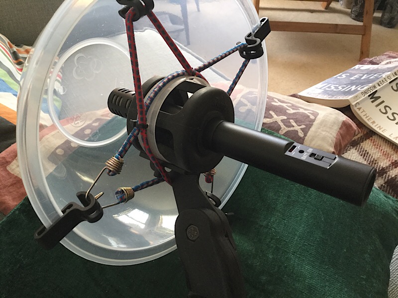

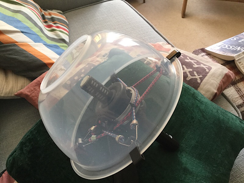

Scratch built Not Parabolic Relector....
I知 totally proud of my efforts.
http://www.dvinfo.net/forum/attachme...1&d=1540393243
Scratch built Not Parabolic Relector....-7584f387-bd83-4960-9700-d3f70920fa4a.jpeg   Scratch built Not Parabolic Relector....-93499345-b4da-4742-a201-ebe9a44654a0.jpeg

Semi-parabolic?
How does it sound? Perhaps this method could be applied to a bigger bowl...

The Mic is a Senni shottie capsule that here is depending on the reflected audio hitting the flat area of the bowl. So not a para. But the audio gets scooped and vibrates the flat area.
How does it work? I知 getting the audio of a soft clicking digital clock, in a garden surrounded by reflecting brick walls from 5 metres. Proof of this is that when I rotate the gizmo by 90 degrees off axis, the clock tick has gone. I had made a prototype back in 1978. This time I believe I致e done it almost right.
