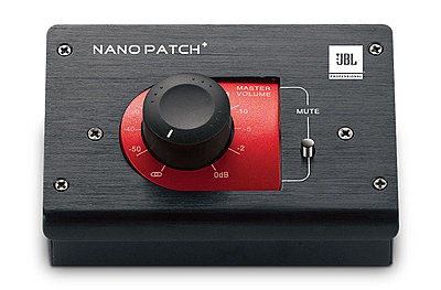

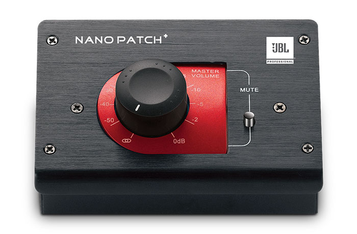

Equal Opportunity Offender
Location: Brisbane, Australia
Posts: 3,196
Re: 2 monitors connected to my PC. How can I manage the volume?
I use a similar product for managing the sound levels for my speakers. The Nanopatch has worked well for me.
Worth noting is that I leave it on the floor and use my left foot to adjust the knob position, leaving my hands to continue with the keyboard and mouse. Just something that really works for me.
Andrew
