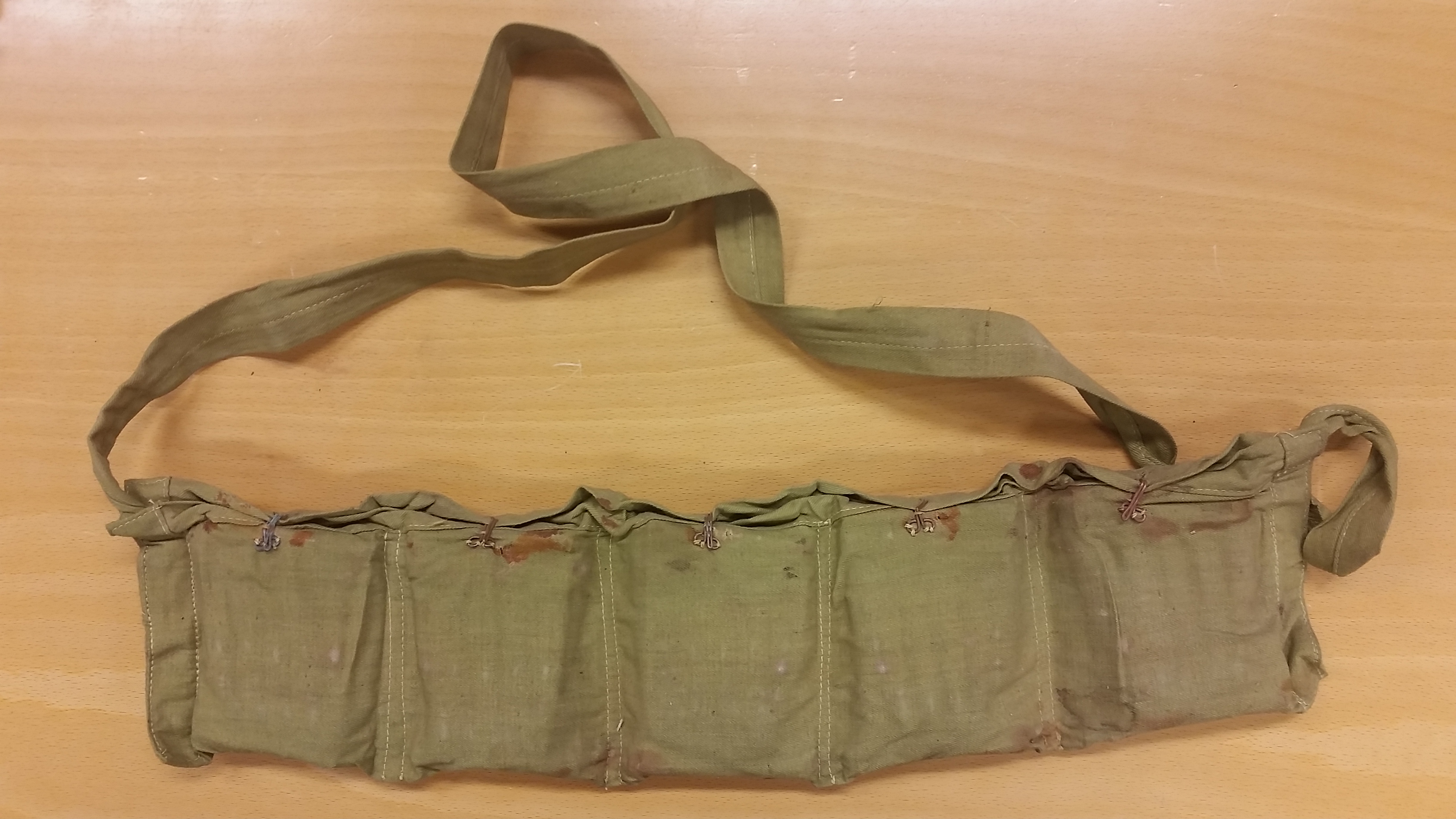

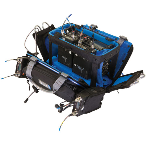

Many/most mobile production sound recordists use some kind of shoulder strap bag which holds the recorder and wireless receivers.
Or you could use a second belt (or bandolier) with all the receivers on it so it can be put on and off as a unit, perhaps even with some 3ft/1m cables for each receiver secured to the belt ready to be plugged into your recorder/mixer.
4 x body pack receivers - how do you manage them?-orca_or_34_audio_mixer_1411056341000_1082112.jpg   4 x body pack receivers - how do you manage them?-20150701_120329.jpg

Richard - this is what I was thinking (having a bag), although the receivers would be loose inside.
What I am also thinking is to use a spare camera rail system to secure the recorder, then mounting a cheeseplate or cheese rod with some ballheads to hold the receivers. It doesn't need to look pretty!

Richard, I didn't see the photos first time round! That last pic might just work :-)
