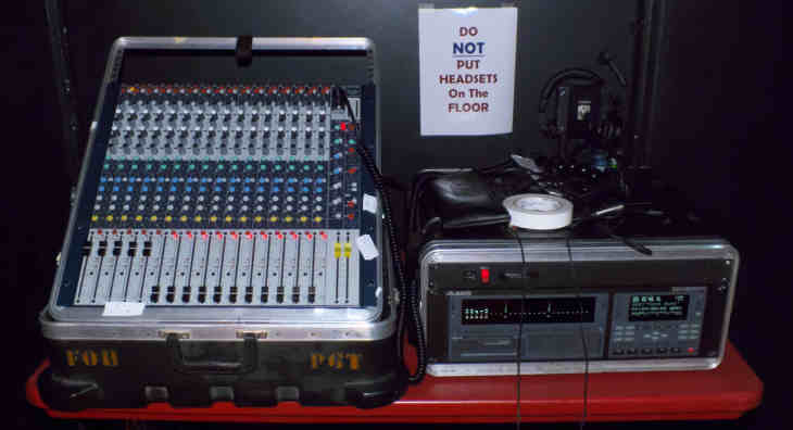

If you're going to be at the venue for the duration, perhaps you can arrange to split the output of the mixer or whatever is feeding the speakers. Or even split the source. If there are multiple sources bring lots of (RCA?) splitters and your own mixer.
I record live music all the time and it's generally not a problem to get some kind of feed from the mixer that isn't the headphone output. I suppose a dance recital may use simpler gear, but it still seems like there has to be a better way.
When I want entirely independent audio I bring my XLR splitter snake and my own mixer.

To be clear, 90% of my live recordings are done on a Zoom H5 getting a mono or stereo duplicate of what the mixer is sending the speakers plus the onboard mics. I've even used the passthrough XLR of active main speakers as my board feed. It works great when the recorder is at the foot of stage with the mics capturing stage noise (amps & drums).
