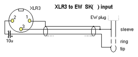

On my lead which is home made. I have red going to tip of the 3.5mm jack and nothing connected to the ring blue and sheld is are connected together and connected to the sleave of the 3.5mm jack.
If you have a multimeter you could do continuity test from pin 2 on the XLR to see if it is the red on your lead.
Pin 1 on the XLR will be the sheld of the cable and 3 maybe the blue on yours.
http://mcgcs.net/xlrto35mm.png
Hope this helps

Thank you Tony, yes, that does help, i'll check that out :)

The CL 100 XLR cable is for the portable receiver, to a balanced XLR input.
If your are putting a 3.5mm TRS plug on a lavaliere mic to plug for a SK100 Tx. The mic cable shield is connected to the Sleeve and Ring terminals, The other two wires go to the Tip.

Hi Rick, I’m putting the 3.5 mini-jack plug on to the end of the lead thats in the link above. I’ve one like that in the link but it hasn’t the mini-plug fitted. Thanks
