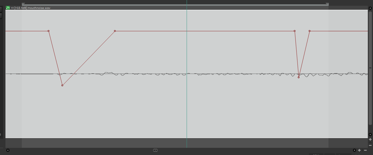

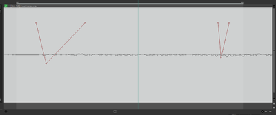

It might be tedious, but fixing each individual artifact is the best sounding solution. I generally don't apply an effect to the whole track to fix short duration imperfections. Sometimes a plugin like a de-esser or de-clicker can help, but often they'll start to affect parts of the track you don't want them to.
Most likely what you're doing is the best approach, but perhaps you need a better tool. My favorite for this is clip gain automation in Pro Tools, but Reaper has a pretty good version of that.
Here's what I did on your sample in Reaper (the image is the waveform just before "decisions"):
Edit / speeding up production-reaper-click-fix.png
