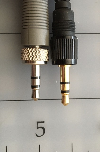

I was able to borrow a Sennheiser wireless lav mic. It didn’t work. The primary impediment was the ring lock on the Sennheiser prevents the full length of the plug to be inserted (see attached picture). Even if I was able to plug it in it still might not work because what Rick said being wired differently. I was happy to learn this before ordering the headset.

All of the molded-on locking plugs I have encountered cannot be used on a conventional non-locking 3.5mm input jack, because the locking ring does not retract enough. (as Pete's photo shows), OTOH, most of the solder-on locking plugs (Switchcraft TecNec, Neutrik) the lock ring retracts to be fully inserted finto a non-locking jack.
.. The Sony wiring config only works on a Sony Tx though. whereas the Sennheiser wiring config will work on most conventional mic inputs that has a 3.5mm jack.. If it is a stereo input it will only feed the left channel though.

Unfortunately there are very few headsets offered for Sony and they’re expensive $150+ this would explain why all high school theater productions use Sennheiser. Btw both are ring locks, the Sony retracts further but it’s disappointing Sony had to be different, the cost rules out getting a headset.
