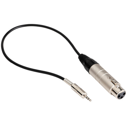

John. If you want a simple and efficient way of doing it follow your own suggestion of using a Kopul LMT100. This is exactly what these were designed for and the price isn't outlandish.
Chris Young
https://www.bhphotovideo.com/c/produ...2855/KBID/3801
Impedance Matching Cable for Dynamic Mic Connection to G4 Transmitter??-kopul_lmt_100_lo_to_hi_impedance_1374831387_885062.jpg
