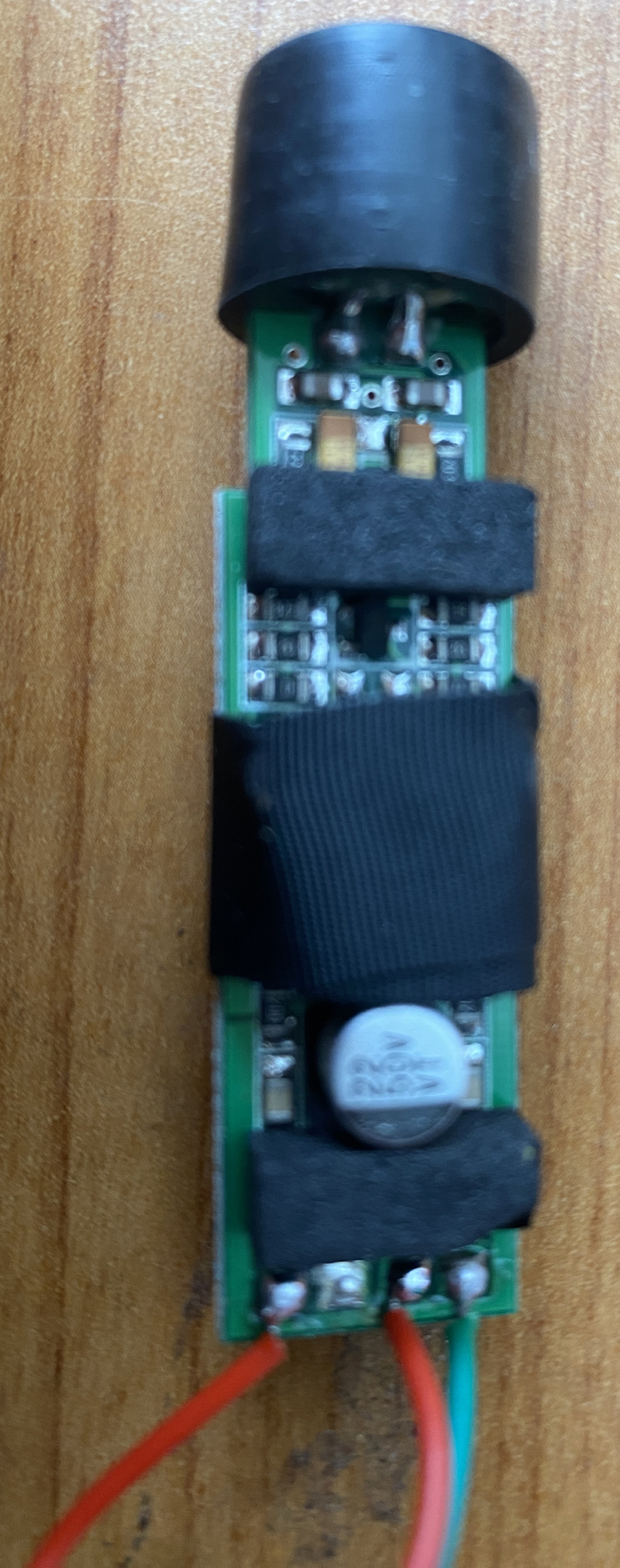

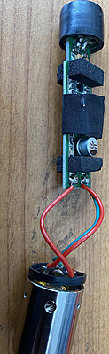

Cheers Gary - have you pulled an 875 apart? I'm wondering how it actually works with those big slots? I'm wondering if it uses two cardioids inside? AT did that in the 80s - two ordinary cardioid capsules about 100mm apart connected together. I guess a phasing thing that gave a more directional performance. I'm loath to pull apart mine as it looks like it needs a screwdriver I don't have and I'll probably chew up the threads.

I have four somewhere I think they were OEM products sold originally for video. The first ones had captive 3.5mm curly cable,then a few years later they had XLRs. Battery power only, no phantom. Slide switch with off, cardioid, shotgun pattern. I used them on stage fronts before I found boundary mics were better. I wonder if they just reused the designing the 875 as there are none of the usual radial slots?

I pulled it apart - It's not two elements, just an electret in a resilient mount. What you can't see from outside, with those big wide slots and plasticky film is that inside, there is a brass tube, and a front to back slot is milled into either side - it's about 2mm wide, and invisible from outside. So it's not like the usual radial slots, but the long slot interference tube - similar in design to AKG CK8 and 9 mics, but much shorter. Quite nicely put together.
