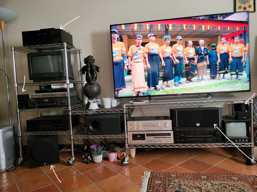

Adriano Moroni November 17th, 2023 04:11 AM
What do you recommend changing in my audio system?
1 Attachment(s)
Hi, I have no experience, but I have good ears. ;) I use the sound system to watch my documentaries. I do the video editing myself and there is a narrative voice in all of them. My audio system includes 2 tweeters, a central speaker (for the voice), a subfoofer and 2 rear speakers (which cannot be seen in the photo). I've marked with arrows the speakers I'm using and the Onkyo amplifier.
My Bose audio system is 20 years old but I replaced the central speaker about 10 years ago and it cost me 100 euros.
Unfortunately when I listen to my documentaries, the voice is not good. Yet if I listen to it with 2 cheap studio speakers, I hear an excellent voice because it is recorded with a mic. professional and by a professional speaker.
I had thought about removing ONLY the central speaker and buying two studio speakers and leaving everything else unchanged. What do you think. Maybe I said something rubbish, but I'm only interested in hearing a good voice mixed with background music, but with this system I don't hear it well. But I'm satisfied with the music that comes out. What do you recommend me to do? I have a limited budget. Thanks for some info.
First, is the dialog only on the center channel, or is it also on the L/R channels as well? Are these documentaries some that you own on disc, or some that you have created and therefore have the masters? Knowing the answers to these questions might help people give you more direction.
From the picture, I see hard tile flooring and a small rug. This implies that your listening room generates a lot of audio reflections (as hard surfaces do). This in turn can be bad for "intelligibility" of the voice channel(s). Small rooms tend to generate rapid first reflections (commonly called "slap echo") which tends to blur the direct sound and create a sort of "smearing" of the audio. It makes it hard to localize sources in a stereo sound field for example, and tends to smear the consonants in dialog.
Small rooms generally need some level of treatment. Typically small rooms need some amount of absorption, some (different) amount of diffusion, and some bass traps. If you use nothing but absorption you end up with a dead sounding room. If you don't use any bass traps, you end up fighting room modes (nulls and peaks at certain frequencies below, say, 350 Hz). If you use too much diffusion you end up with a room that's too bright and too lively.
So, how to know how much is enough, and how much is too much? You need a computer program like REW (room equalization wizard), a calibrated microphone, and some cables so the computer can play tones through your AVR. It works by the computer playing frequency sweeps and listening to how your room responds through the microphone (at your main listening position). You can then generate graphs on your computer that show you what's actually happening in your room at all the pertinent frequencies. As you add room treatments, you rerun REW and see how what you've added changes the room's response.
Or you know it could be something as simple as your center channel being out of phase with your L/R pair. REW will tell you this too I believe. But so will swapping the ends of the cable at the center channel.

I need you explain better. Near that small carpet there is a bigger carpet, then there are the curtains. It's not a soundproof room but it's not bad.
I make my documentaries and I make the video editing. I have the master for every documentary.
I'm thinking to buy one of two speakers Elac DEBUT 2.0 B6.2 or Elac Debut b5.2 and plug it on Central. I will remove the 2 small tweeter. For me the best thing is to listen a good narrative voice in my dicumentaries.
Since I also have a Subwoofer (look at the photo), I think I'll buy Elac Debut b5.2 instead of Elac DEBUT 2.0 B6.2 is enough to listen a good voice. What is your thought?

If dialog is isolated to the center speaker (as is normally done in 5.1 soundtracks), then the problem is more likely to be the room, or the speaker. If the dialog is spread across the front (L/C/R) as is sometimes done so that dialog can be heard in situations where a center speaker is not available (using the L/R pair to create a "phantom center channel"), your problem could be caused by one or two speakers being out of phase with the others. This will make the dialog sound "hollow" and it will be hard to locate in the room (it will not sound like it's coming from the center speaker as it should). Flipping one end of the speaker wire coming into the various speakers will eventually reveal a fix for that problem too.
So in the first case, a new center channel speaker may help. Elac has a range of center channel speakers, I would tend to use one of those instead of one of their "bookshelf" speakers because of the improved horizontal dispersion, which helps intelligibility. I'd probably push you more toward the Elac Debut Reference Center Speaker – DCR52 (or the less expensive ELAC Debut 2.0 C6.2 Center Channel Speaker – DC62), if it fits where you need it to go. But of course, it's your decision. Whatever you buy, set it up so that it points directly at your ears (you may need to tilt it up or down a bit, as well as pointing it L/R) when you are in your main listening position. This gives you optimal direct sound (maximizes signal to noise (reflections) ratio).
In the second case, dropping the dialog from the L/R pair and letting the center channel carry the load alone will probably help quite a bit. Reflections in a small room are tricky; I like my reflections to have a single source when possible. When L/C/R are all the same signal (but spaced apart) they create three slightly different sets of reflections; things get messy quickly.

Your reply clear many many concepts, but perhaps I have too many gaps. I'm not an expert.
The dialog of my documentaries is always isolated to the center speaker. But I listen a bad narrator voice.
Maybe that center speaker I have (JBL) doesn't communicate well with the 2 very old Bose tweeters. I don't know this, but I am dissatisfied. So I don't think I'll leave the dialogue of my documentaries only in the central speaker. Perhaps by adding 2 more Elac speakers on the Centre, listening could improve. I hope!!

Yes, the problem is the voice-over narration. But the voice of the doc. that you have listened satisfies me. Now I no longer have that speaker, but I have another one with a more powerful and bigger voice. Now I even struggle to understand the words if the music in the background of the voice is not mixed perfectly. Listen to one of my docs. it got a little stressful because of that.
For this reason I would like to do something to my audio system, but without spending a lot.

I think there are really two separate issues: (1.) how should the playback system be changed, and (2.) how can the mix be improved?
** Comments about the playback system:
• All three speakers should be as close as possible to ear level and the same level above the floor. They should be centered (left to right) relative to your listening/mixing position, so the sound from all three arrives at your ears at approximately the same time and volume. Where the heck is your center speaker? If we can't see it, it's certainly going to sound different from the other two ... probably muffled if it's hidden behind something. You want the three of them to sound as similar as possible; you do not want some "special sounding" speaker for the center channel.
• You definitely need to be sure all three speakers are in phase. Be sure the amps are connected identically. If your speaker wires are color-coded (e.g. red and black) this is a quick way to check, but listening tests are of course the final goal.
• Is your playback system equalized at all? How? Where in the chain?
• The narration sounds better on your small, cheap speakers because they reproduce less of the frequencies outside of the voice range, so they will make the voice stand out from the other audio. This makes me suspect that there is a problem with the mix.
• I do agree with other folks' comments about adding some acoustic absorption to the room to lessen reflections. That will help intelligibility *if* the voice is loud enough and properly equalized to begin with.
** Comments about the mix: (I listened to parts of the same video that was referenced by Bruce Watson, so other mixes in other videos might be different.)
• I agree with Mr. Watson's comments about muddiness of narration. In fact a big "AMEN" to all of his detailed suggestions (which he wrote while I was writing this). The narration need some restorative EQ, plus careful gain-riding and/or some gentle compression to keep the levels up.
• At times the narrator speaks in a very "intimate" and "personal" tone of voice, rather than projecting his voice at "normal" level. The intimate tone of voice has a different balance between high and low frequencies, so it sounds even muddier.
• In some spots the voice level is definitely lower than the music level. Listen to how the voice trails off at the end of sentences, for example around 6:40, 6:46, 6:55 (in the latter instance he's whispering). The diction is unclear and the voice level is lower than the music level; of course the narration will be difficult to hear.
• Lots of wind noise in the location audio around 10:20 ... a foam or furry wind screen, and/or HPF would help correct that.
• There's an abrupt upward jump in music level at 13:58. (No narration at this point, but why the abrupt change?)
• Contrast is your friend. Just as the white subtitles would be easier to read over a black shadow, rather than over a gray shadow, greater difference between narration and background audio will make the narration easier to hear and understand.
*** Changing your playback system won't automatically "fix the mix" but it should make it easier for you to hear details like these initially.

So I could save money by not buying any other speakers, but by adjusting the position of the ones I already have.
Honestly I was thinking of removing the 2 small speakers because I've had them for more than twenty years and maybe putting in something better I thought it would have been better.
Having said that, I would like to point out a video in which the voice is from the same speaker as this video with which I have listening problems. But both voices were recorded in different studios, but always with mic. professional. The other video is this:
Don't you think I could take a test? Instead of raising the central speaker (the one with the voice) I could sit on the ground to understand if anything changes when listening to the voice.
I honestly don't know how to turn up that center speaker, I don't know where to put it to get a better voice. Look at the photo in the first post. Perhaps this is the main problem. If I were to buy 2 more speakers, I would have the space and height to listen better. But then I don't know if it's a waste of money.

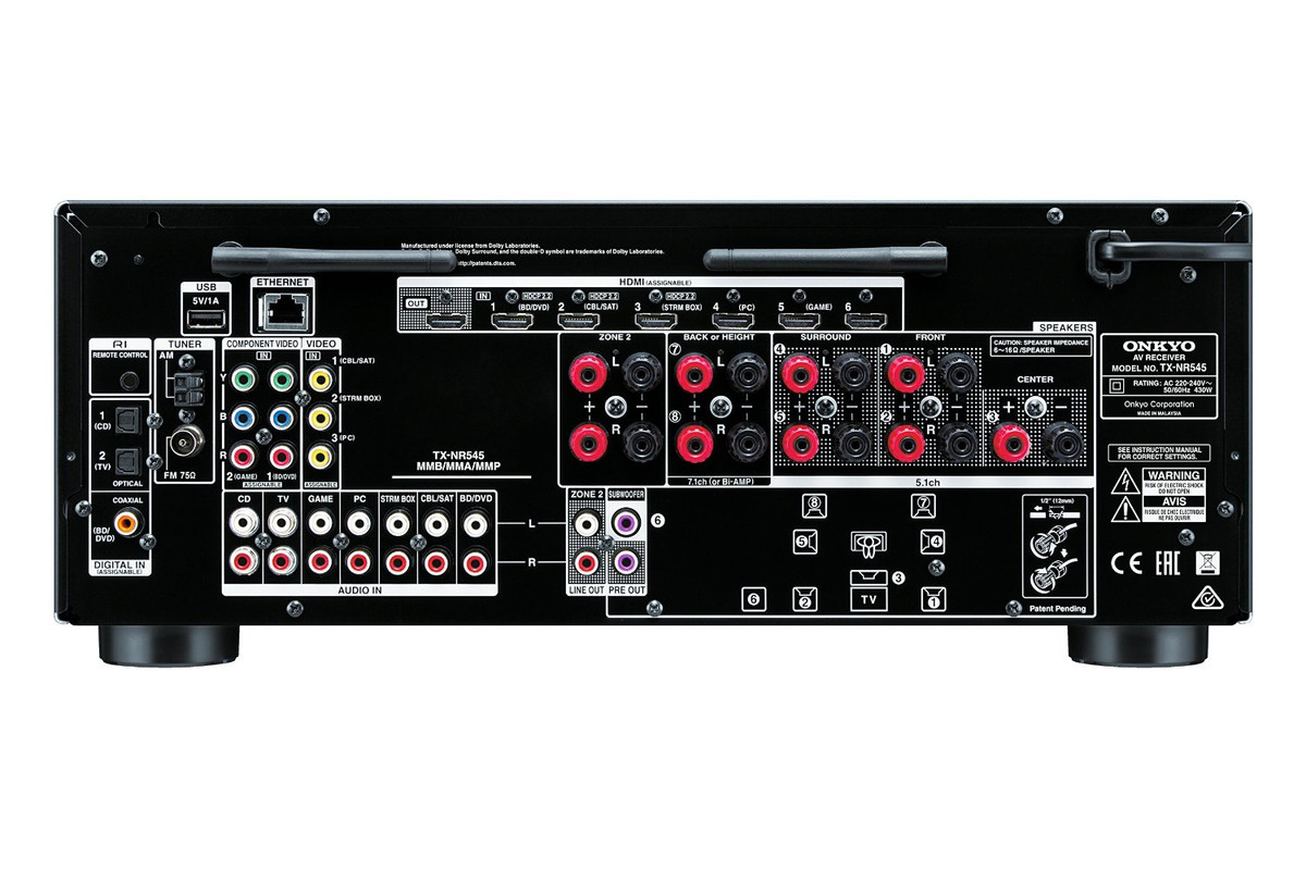

Please, excuse my ignorance regarding audio. I would like to ask a question: I noticed that both the narrator's voice and the music come out of the central speaker. This happens whether the narrative voice is present or not. Is all this normal?
PS: Do you think that moving the central speaker to a higher but decentralized position compared to the TV is better? I would like to place it on the left when looking at the photo, but facing the viewer. Look at the photo attached below.Do you think I will hear my voice better?

You probably don't know the Onkyo TX-NR545. Among the various options I don't see 5.1, I only see the "Surround" option.
PS: If I were to buy 2 Elac Debut b5.2 speakers, to be able to connect them to the Onkyo, would you recommend using a 2 or 4 mm cable?

I have a simple mind. Let's understand a few things simply.
1.) You keep talking about "tweeters." By this do you mean the left front and right front speaker? ("Tweeter" means a speaker that reproduces only higher frequencies. Depending on the system, this might start as low as 500 Hz, but much more likely starts from about 1,000 Hz and upward.) If you're talking about left front and right front speakers, for the sake of clarity call them that, or LF and RF.
2.) Please tell us the make and model number of those LF and RF speakers.
3.) You mentioned earlier that the (front) center speaker is not visible in your photo. Where is it? What is the make and model number?
4.) Also, in an earlier post I suggested that all three speakers ideally should be at the same elevation, roughly the elevation of the listener's ears. As far as I've been aware (for the past 60+ years) loudspeakers are somewhat directional. Therefore, ideally, the listener's ears should be roughly on axis of the speakers. If the speakers are sitting on a flat shelf (i.e. not tilted upward or downward) that means ideally they should be roughly at the same elevation as the listener's ears. I certainly think you can't go wrong with this placement. It will help eliminate delay/phasing issues when trying to evaluate a mix. Does someone want to disagree? If so, based on what?
(By the way, Adriano, you asked about sitting on the floor, to get your ears lower. That problem is that you can get a lot of reflections from the floor, so ideally you want neither the speakers nor your ears to be too close to the floor [or to the ceiling, either]. I think a good elevation is normal seating position, where your ears are probably ~1 meter above the floor. Your video display screen is roughly at eye level, right? Why not take the same amount of care with the audio? I probably wouldn't be as concerned about this, but since you keep wanting to change your playback system, I can't help feeling that we should get things as close as possible before spending any money.)
Yes, I mean those small Bose cubes.
There isn't the model on 2 Bose cubes, but they are around 20 years old.
I didn't write it, I wrote I have "2 rear speakers (which cannot be seen in the photo)". If you look at the pic I attached on the first post, you wiill see every speaker I'm using in front.
Anyway the 2 speaker you can't see are Yamaha attached to the walls dx and sx. But I can't read the model. The central speaker is JBL ES25C. It is a three-way speaker. I bought it around 9-10 years ago and I paid it around 140 euro. Then I have a subwoofer on the ground and it is Yamaha YST-SW012 and if I remember well I paid it around 150 euro.
I did a test by temporarily turning up the speakers and I heard the audio of my documentaries better. I will do it later permanently, even if it is almost impossible for me to raise the central speaker.
English is not my mother tongue. Thanks for your patience.
https://i.postimg.cc/BQjd2HFk/TV-con-frecce.jpg
https://i.postimg.cc/tCztNg3G/Onkyo-...posteriore.jpg

Thanks for all the details. I apologize for mis-reading or mis-remembering what you said earlier about your speakers. It is more clear now.
I am not too familiar with the Bose brand of speakers. I think Bose's goal, in general, was to get "better than average" sound from "smaller than average" enclosures. Some of the early models were quite unusual. I have tried to find some information online about the small cubes that you have. What I am about to say is not from my own knowledge, it's just a summary of what I could find online, so forgive me if it's wrong. Maybe another forum member knows more details about them. And you'll see I have more questions for you.
Apparently the cubes are not full-range speakers. In particular they do not reproduce low frequencies ... they are perhaps good only as low as ~200Hz. (I still won't call them "tweeters" because 200Hz is below what we normally call "midrange." But since they're not full-range either, maybe it is best just to call them "cubes.") It seems that the cubes were part of an overall system that had its own Bose subwoofer (or perhaps I should say "woofer" without the "sub"). Both output channels of the stereo amplifier were connected to the Bose woofer. The woofer cabinet contained crossover wiring, which sent the low frequencies to a larger driver in the woofer cabinet; it sent the higher frequencies (above ~200Hz) to the two cubes. Without the special Bose woofer, the cubes would not sound correct on their own.
So (again remembering that this might not be the correct info for your particular speakers) I need to ask specifically: Is this the kind of system you have? Is that a Bose woofer that I see sitting on the shelf? And are your cubes connected directly to your amplifier, or are they connected directly to the Bose woofer (if that is what you have)?
I think before saying much more about speakers, it's important to understand the above details.
Again I apologize for my confusion, and thanks for your patience with all these questions.

Thank you for providing the additional info about your system! Now I understand even more.
To talk more about the history of the Bose company. Some of their early speakers used only fairly small drivers. Normally these would not produce very strong bass. The lower frequencies would "roll off" (get weaker as the frequency got lower) as one would expect with those small drivers. So Bose included special electronics, which boosted the bass in a way just the opposite of the drivers' rolloff. That somewhat restored the bass, although it introduced other problems.
In a way your original cube system was a bit better, because at least it admitted the need for a real woofer. But the question is this: exactly how did the electronics in the woofer affect the signal fed to the cubes? If you don't know that, and don't have a proper equalizer (made by someone other than Bose) then the new system (the cubes plus your new woofer) will never have the correct frequency response. So, when you listen to a mix to evaluate it, what you hear will be different from what other people (with more proper speakers) will hear.
Right now, you have a little bit of bass coming from the cubes (although at a fairly soft level). You have more bass coming from the sub in the corner. And more coming from the center speaker. Are all those things in phase? (I would not be surprised if the center speaker is out of phase with the others!) Do they have a correct frequency response? If all this stuff isn't correct, it could be part of the reason your system sounds muddy.
Now that I know all these details, I do agree with your original thought. If you want to make any changes to your system, the Bose cubes would be a good place to improve! I am an old-school guy myself. I tend to like JBLs for mixing & listening. JBL makes a lot of professional speakers for theatre and music performance use, so I trust their smaller monitor speakers. I think a lot of albums and a lot of movies were mixed using JBL monitors ... they are professional speakers. I am *not* telling you to buy JBL, but I definitely would avoid "home" brands like Bose. Also, I know that speaker prices vary widely depending on the country where they're made and the country where they're bought. So I don't know what would be a good price/performance choice for you. I'm sure some other forum members with European experience can give you better advice than I could.
Now, I hope I won't bore you, but I'll come back to the detail of speaker location. When you watched a movie in a big conventional theatre, did you think about the speaker location? You might already know that the speakers are *behind* the screen. Professional projection screens are perforated, so the sound can come through the thousands of holes to reach the audience. The speakers are neither below the screen nor above it. They are roughly the middle of the screen height. So, again, for your mixing/listening room, I'm going to suggest that you try to position these new, better speakers so they are roughly the middle of the height of your video screen ... about the same height as your ears. (Yes, I see your photo, you have a beautiful huge screen. And I like the way you have connected the shelf units together to get more useful space. I know what I suggest won't be simple. I can only say honestly that I think it will let you hear your new speakers as they should be heard.)
Then for the time being turn off the center speaker. And make sure the subwoofer (in the corner) is not too loud. I think you will be much happier with your new sound!
