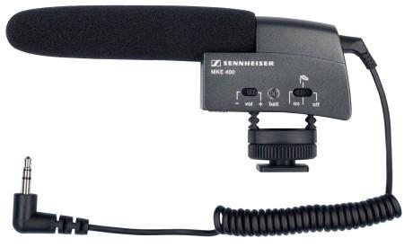

Wow - Sennheiser is listening - the ME36 made smaller for camcorder use - Introducing the MKE 400.
http://gadzetomania.pl/2007/05/12/mi...eiser-mke-400/
Guy Cochran
