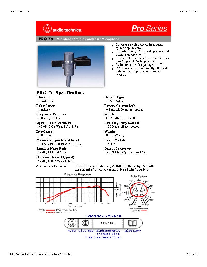

This is what we're using (see attahed image)
There's an illustration of a such a loop near the bottom of this Tech Tip page. Also pix on anchoring a mic between layers of fabric using triangles of gaffer's or surgical tape.
http://www.locationsound.com/cgi-bin...chtips8_4.html
