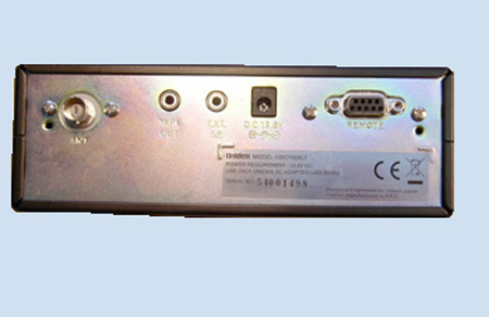

The best way to do that is to use a scanner that has a "tape out" or line out. Most Uniden mobile scanners have a tape recorder output. Another way would be to tap into the line level signal inside the Sony scanner. You'll need the schematics and a soldering iron. Essentially you'd be bypassing the internal headphone preamp. I did this on a Yaesu VX-7R and the audio is pretty good.
Handheld scanners/receivers usually have a headphones only output, unless it's a specialty receiver like the AOR 8200, for example.
Anyway, if you need this for sound effects only, and it doesn't matter what the content of the radio traffic is, you might want to check out some live online Air Traffic Control feeds at LiveATC.net.
They also have an mp3 archive of those feeds. That'll save you the trouble of having to record a live feed.
Finally, I Just wanted to say, good luck! We're all counting on you.
Edit: Added picture of the back of a Uniden 780. Note the "Tape Out" jack.

I think that's exactly what we need, Adam. So now I just need to find a scanner with the air-band freqs and those outputs and we should be set!
