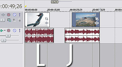

An L cut means that the audio relating to a picture continues after the picture ends, and a J cut means the audio portion of the video begins before you see the frame
VVVVVVVVV
AAAAAAAAAAAA
Creates a "J" cut.
VVVVVVV
AAAAAAAAA
Creates an L cut.
make sense?
Douglas Spotted Eagle/Spot
Author, producer, composer
Certified Sony Vegas Trainer
http://www.vasst.com

Old January 15th, 2007, 11:23 PM   #15
Location: Stockton, UT
Posts: 5,648
Well...it looked right when I typed it, but you're right, it doesn't display correctly. Oops.
I'm sure he'll figure it out.
Just in case, here is a pic from my Vegas book. ;-)
novie question: loud/quiet/loud troubles!-l-jcut.jpg
