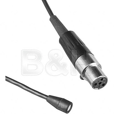

Bulk of the windscreen? Just to clarify, I wasn't using the foam windscreen like these here...
http://www.bhphotovideo.com/bnh/cont...cessory_detail
I was using the one that is pictured on the mic here...(see attachment)
The little silver windscreen on the top of the mic, would you think that is too bulky? Would it be safe for the mic to be taped down without it? Just wondering. Any info or light that you could shed on the matter would be great. I do appreciate your advice.

Thought you meant you'd used a foam widscreen. My mistake. The mesh cap shouldn't be too bulky.
