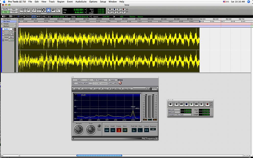

I just threw the file into ProTools and looked a frequency analyzer. It seems to be a modulated signal of 6349 HZ, There is also a steady tone of 16,000 HZ that is in audible. L and R channel are slightly out of phase.
To me it sounds like some sort of Radio Frequency telemetry interference.

The noise is below the room tone. I think it is mostly audible due to its high frequency compared to the room tone. So I would not be surprised if a sound guy with headphones did not hear it during the take. The approx 16 khz bump I am seeing might be the horizontal sync frequency from a monitor in the room. If that is the case, the XLR runs are probably picking up some crap.

Here is a screensot that shows what I think is the video sync at about 16 kHz. I do not think that this is what you are hearing, but it does indicate that your mic line is picking up a signal.
To me the noise still sounds like two modulated tones one around 3000 and one around 6000. In fact you can see them as the smaller blips on the screenshot.
A 6000 Hz tone is pretty directional. If that was in the room I think someone would have noticed it when they got in a 'sweet spot'.
